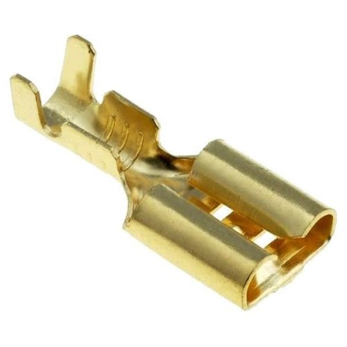

- Cables to connect. I have used a combination of fastons and female pins to make cables.Notice that there are two buttons, so with four fastons and four pins you have it done. It can also be welded, etc.
Faston (for the side of the microswitch) |

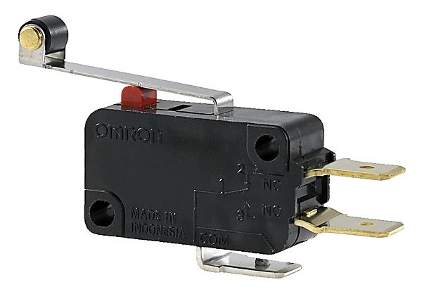

- Fastons (3.00 € / 100 units) is perfect. Pines (2.69 € / 150 unidades) Plastic covers (3.00 € / 100 units). EYE: When you buy the button, look at the width of the microswitch to buy the faston that corresponds (there are of 6.3mm, 4.8mm, etc). The cable any finite cable is worth.
Microswitch Check the width (4.8mm or 6.3mm) for the faston |

Now we have to wire the issue. One of the graces that has the Arduino Micro is that it has pull up resistances inside, for the digital inputs. These resistors are what they do is that they prevent the burn of the micro, since to have a switch, it is necessary to "pull" of the current while closing the circuit. If you did not have these internal resistors, you would have to wire them between the buttons and the arduino, but in our case, it is not necessary, so the assembly is very simple. The microswitches have three legs, the bottom one, NC (2) and NO (4). The "down" is the GROUND and is punctured to the GROUND of the Arduino. The NC (also labeled 2) is NORMAL CLOSED, and is used when you want to use it in reverse (it beeps when it opens). We want it to "pite" when it is closed, so we use NO (also labeled 4).

The cables are prepared as follows: on the side of the Arduino, we mount a pin connector. For that we peel the cable, crimpamos the part of metal, and we put its plastic fuse. At the other end (the part of the microswitch) we put the plastic hood on the cable, and crimp the faston. Ready. We make four of these, which are what we are going to need. The length of the cable is important, so keep in mind how far you have drilled the holes and where you are going to pull the USB cable.

- Pin D9 from the Arduino to the NO (4) of the Left Switch (Q)
- Pin D8 of the Arduino to the NO (4) of the Right Switch (E)
- GND Pin Left to Switch E
- GND Pin from right to Switch Q
