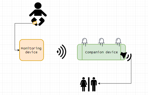

The design of our device can be split into three main aspects: the electronics, the physical design of the objects and the design of the interactions.
Electronics
The main electronics that are needed include a heart-rate, SP02 and a temperature sensor. A colorimetric sensor may be added depending on the time that we have. The different sensors have certain specifications that need to be followed in order to obtain a device which is secure and small enough for the child.
Specifications:
- as small as possible: Each component must be maximum 1.2 cm wide and 4 mm thick.
- low power: Each component must run on max 3.6V
- cheap as possible
To transfer data and run the code we will need a microchip and 2 ESPs as internet connection may not be accessible parts of different countries.
These specifications will allow the product to be accessible to populations with low income. Furthermore, batteries will be able to last the required time (1-2 months ) in order to help the parents.
Object design
Our project relies on two objects: a wearable for the baby and a companion object to alert the parents when something is wrong and advise them on the reaction.
The design of the baby accessory is both more constrained and more important for proper function.
In order for the measurements to be precise, the sensors need to be maintained in an appropriate position. For example, heart rate sensors need to be in contact with the skin.
We have identified some important issues due to the delicate nature of the users. The skin of preterm babies is often very sensitive. Materials need to be chosen according to this, and the design of the wearable has to protect the skin from abrasion by the electronic component. Simultaneously, the accessory should be adjustable: newborns grow fast and all of the preterm baby's measurement are expected to grow greatly during the time they will wear our device.
There is also the social significance of accessories to consider. We have been advised to favour the leg, the ankle or the foot to place our monitoring device, as accessories worn to the wrist or the head often have cultural meanings.
In addition to this, as a wearable, the device should be washable and at least slightly waterproof. It should be sturdy enough to be worn permanently in varying environments for up to a few months.
Our main lead currently is to place the sensors on a sock-like elastic band around the foot and the other electronic components in a tight bracelet. The sensors will come in contact with the skin thanks to windows in the textile material of the foot bracelet.
The companion object should be as mobile as possible. As for the wearable device, it should be safe around young children. We are currently iterating on a geometrical shape with a speaker and light indicators on the top and indicative instructions of the sides.
Interactions
To interact between the monitoring device and the companion device a method accessible to all with and without internet connection must be used. [more information on the companion device interactions with the parents will be published when we obtain the required knowledge from health professionals ]
