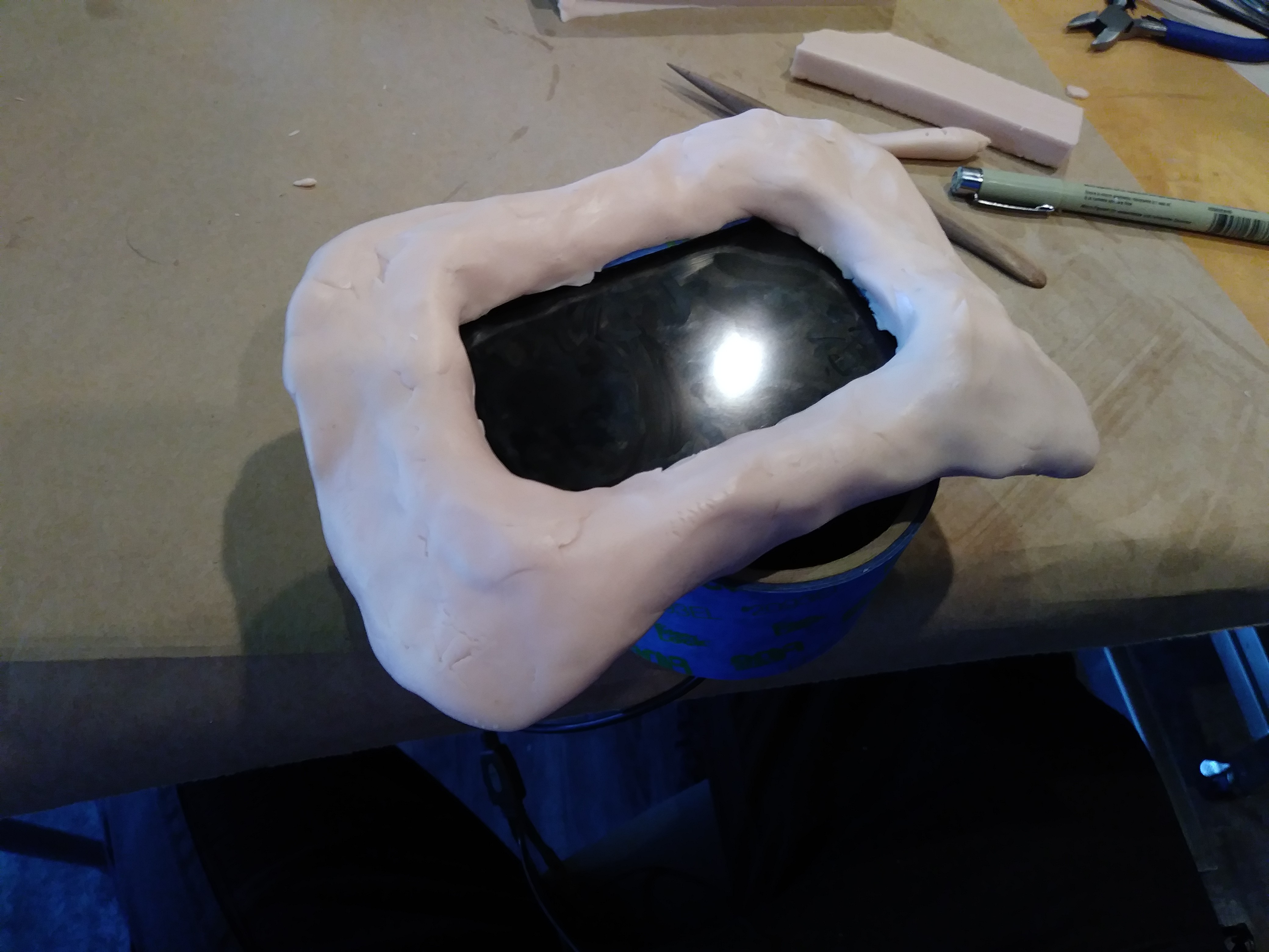

    A friendly beezel cover. There could man many varioations either sculpted and casted or 3d printed. I have been in favor of traditional sculpting when possible. I would love to make a silicone cast to add to the softness of the entire robot. The freckles are a result of torching the polymer after baking.
