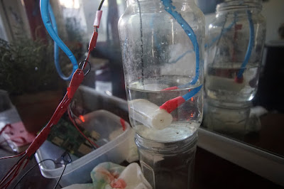

Hardware Setup:
Once the wiring has been completed, attach the flexible hose to the pump (I used electrical tape), and drop it into a jar of water. Attach the other end of the hose to your plant.
Now plug in all power sources (and make sure your Raspberry Pi is running some version of an operating system, like this one here).
