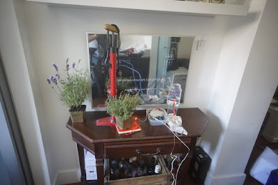

After reading about how well things can grow indoors, I started thinking that maybe automation was my path to healthy plants. So I decided to build the bare minimum - get a plant, a pump, and a water sensor. When the water sensor says "no water here", use the pump to put water there.
I also decided to run it all through a Raspberry Pi to as an excuse to interact with the RPi GPIO.
Here's how I did it:

Hardware Setup:
Once the wiring has been completed, attach the flexible hose to the pump (I used electrical tape), and drop it into a jar of water. Attach the other end of the hose to your plant.
Now plug in all power sources (and make sure your Raspberry Pi is running some version of an operating system, like this one here).
