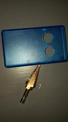

We started with using step bits to drill two holes into the enclosure for the ultrasonic sensor

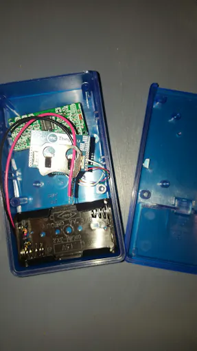

Because the enclosure had the opening for the battery pack, we decided to connect a 2 x AA battery holder to the mcModule120. This way we can power the device using AA batteries and increase the life of the device dramatically!
We then inserted the ultrasonic sensor into the holes we drilled and installed the rest of the electronics into the enclosure
we then put some batteries in, closed up the case
And done!
