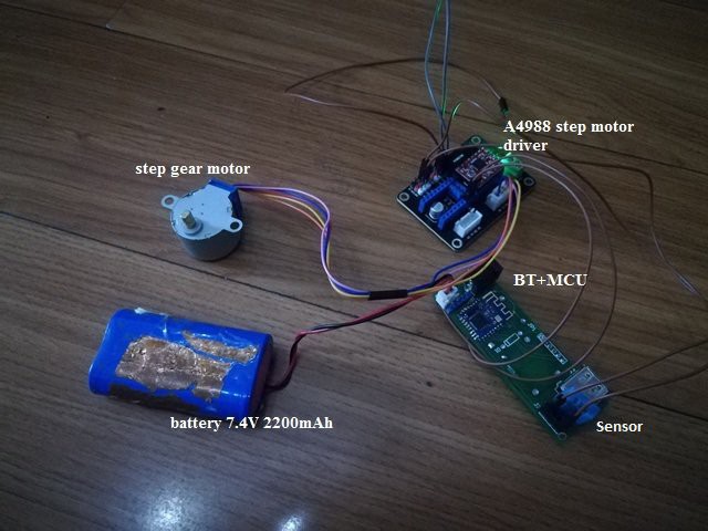

I designed the App, now this function works perfectly. After that, I move to the power consuming. If the power consuming is high, the robot could not work for a long time. It is not an easy thing until I found the low power consuming bluetooth BT4.0, now it can stand by for 20 days.
3. What makes difference?
At beginning, I would like to design an affordable product for any family, and easy to assemble, so you can DIY own one. As a result, I gave up Arduino and chose the low power consuming Buletooth BT4.0 and latest chip CC2541 as the controlling system. You also can understand the reason why I preferred to Android-based phone as the brain of this robot.

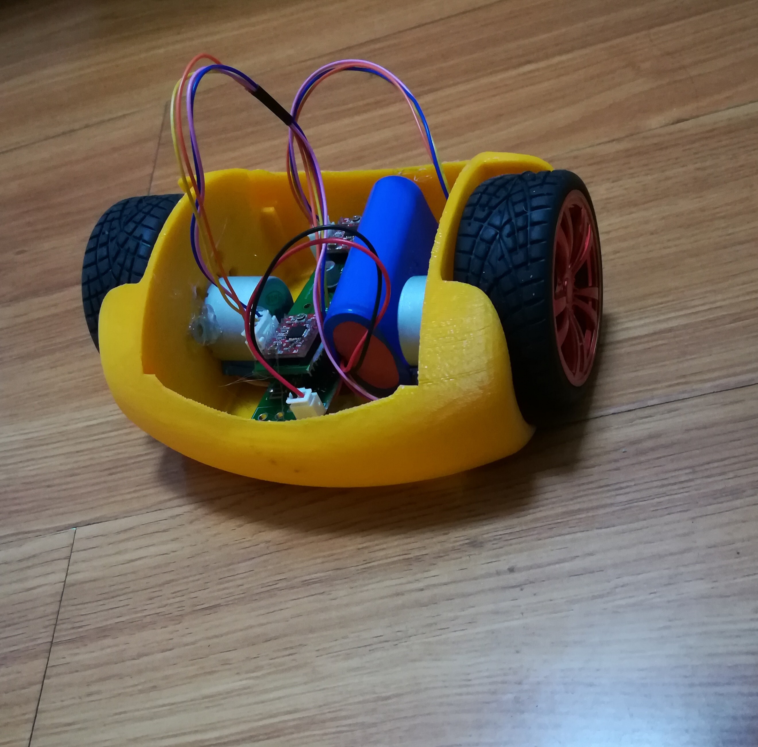

5. Hardware
Here are the part list:
  • 1 x Chassis
  • 3 x Motor
  • 2 x wheel
  • 1 x battery 2200mAh 7.4v
  • 1 x Charger
  • 1 x Control board
You can design chassis and print it by 3D printer. That is very cheap, is that right?
