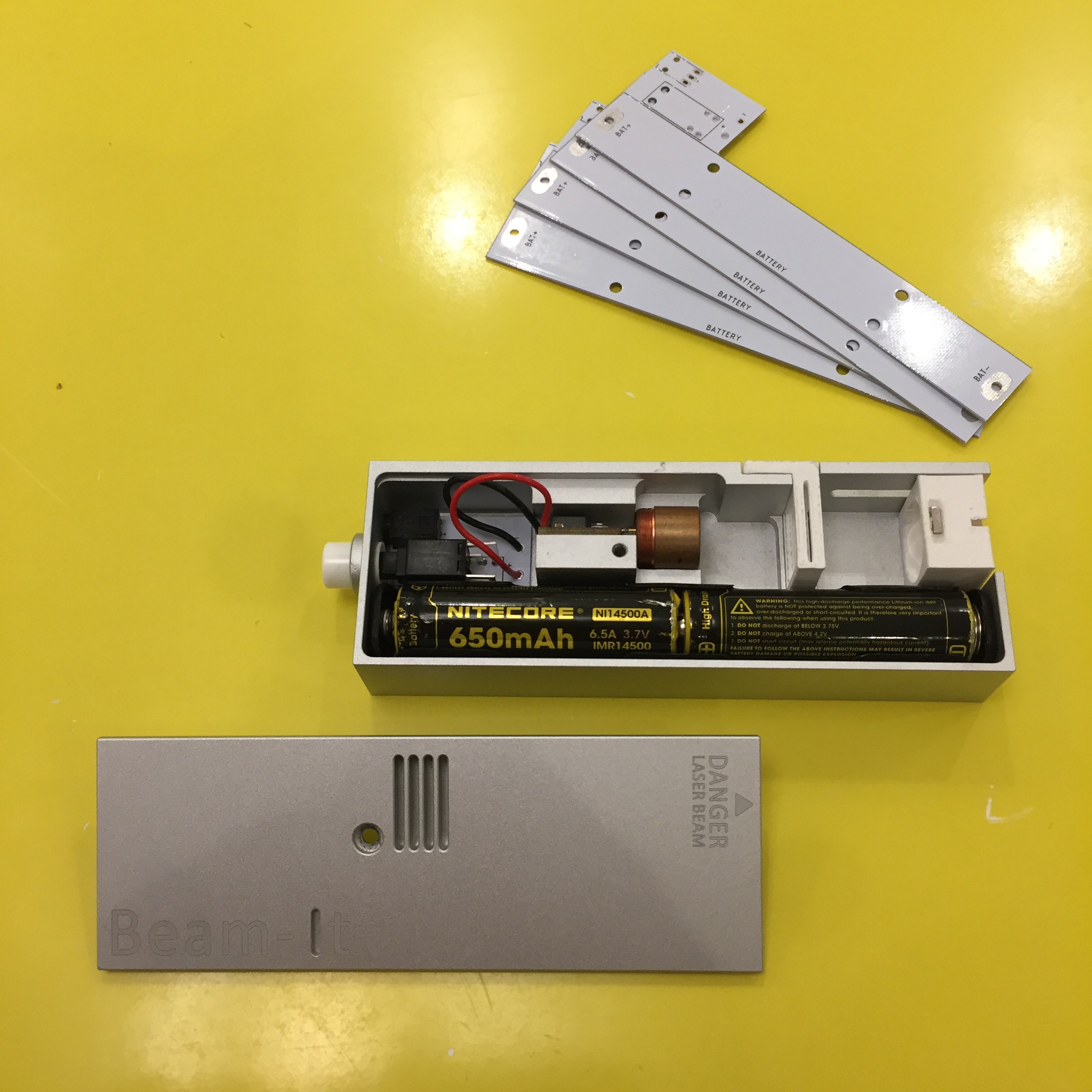

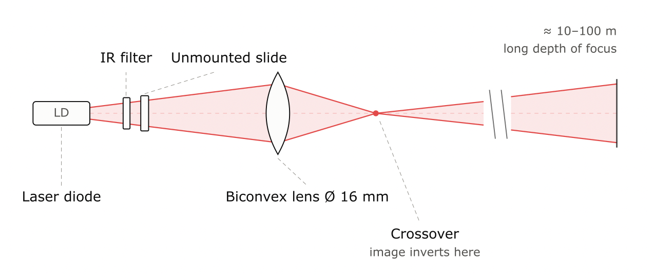

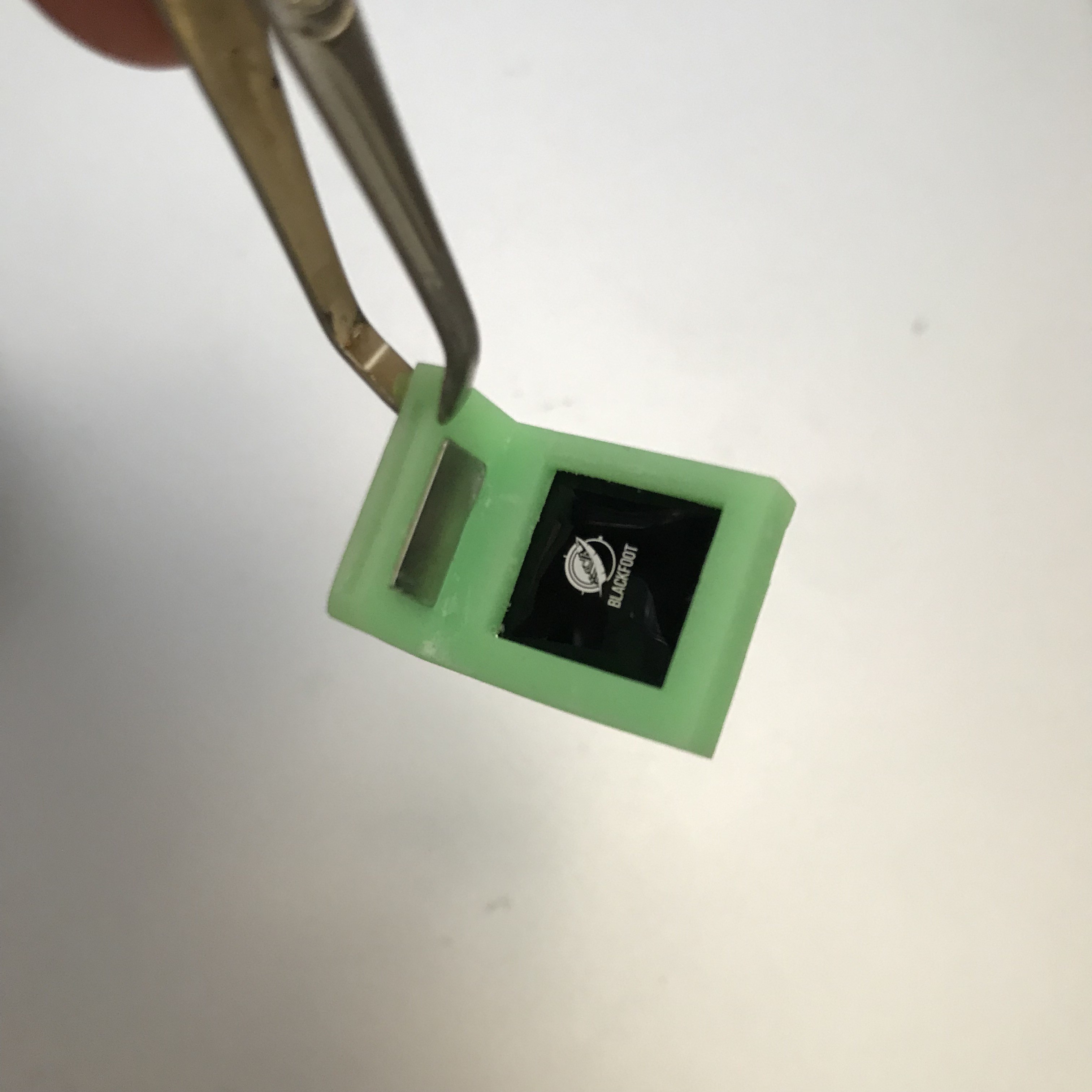

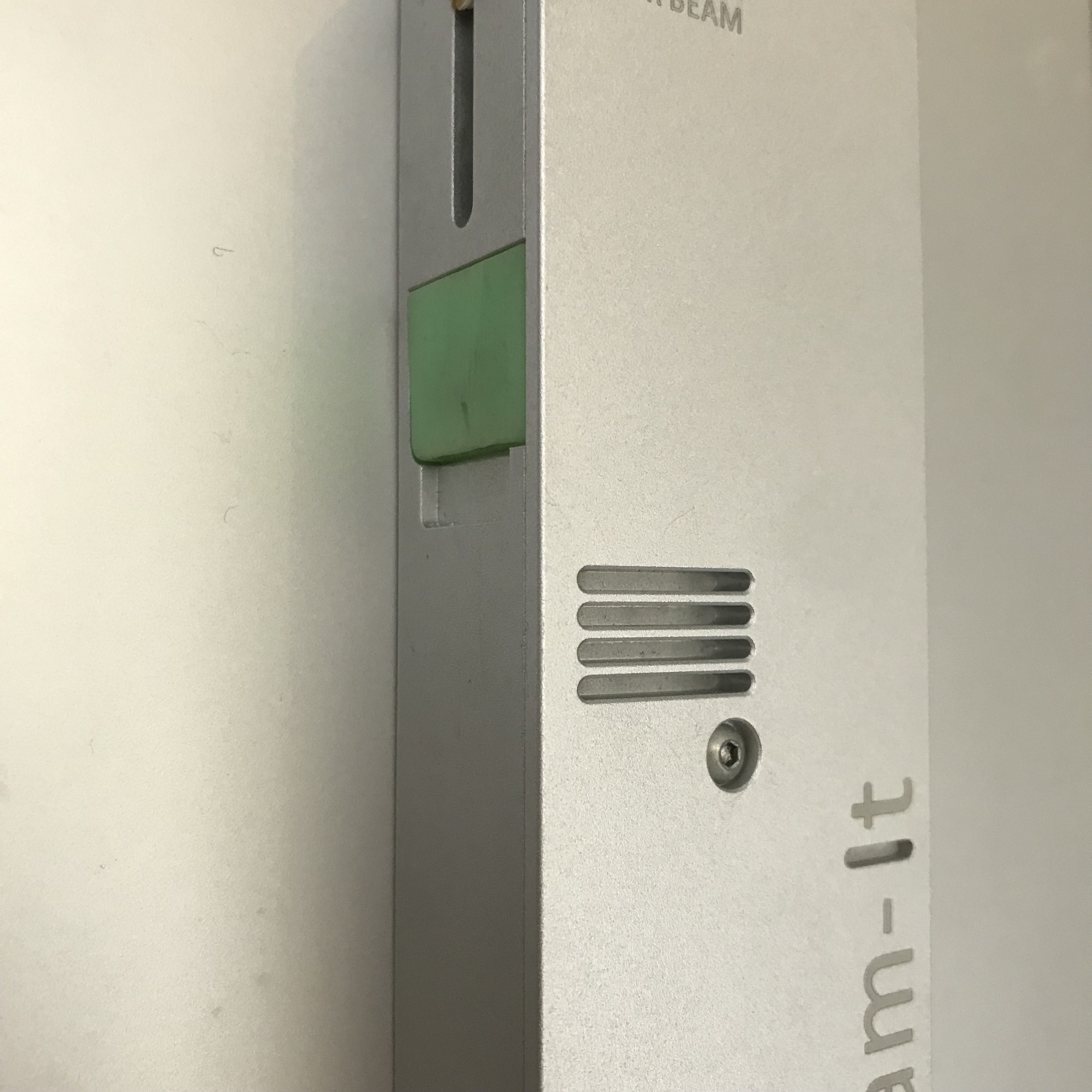

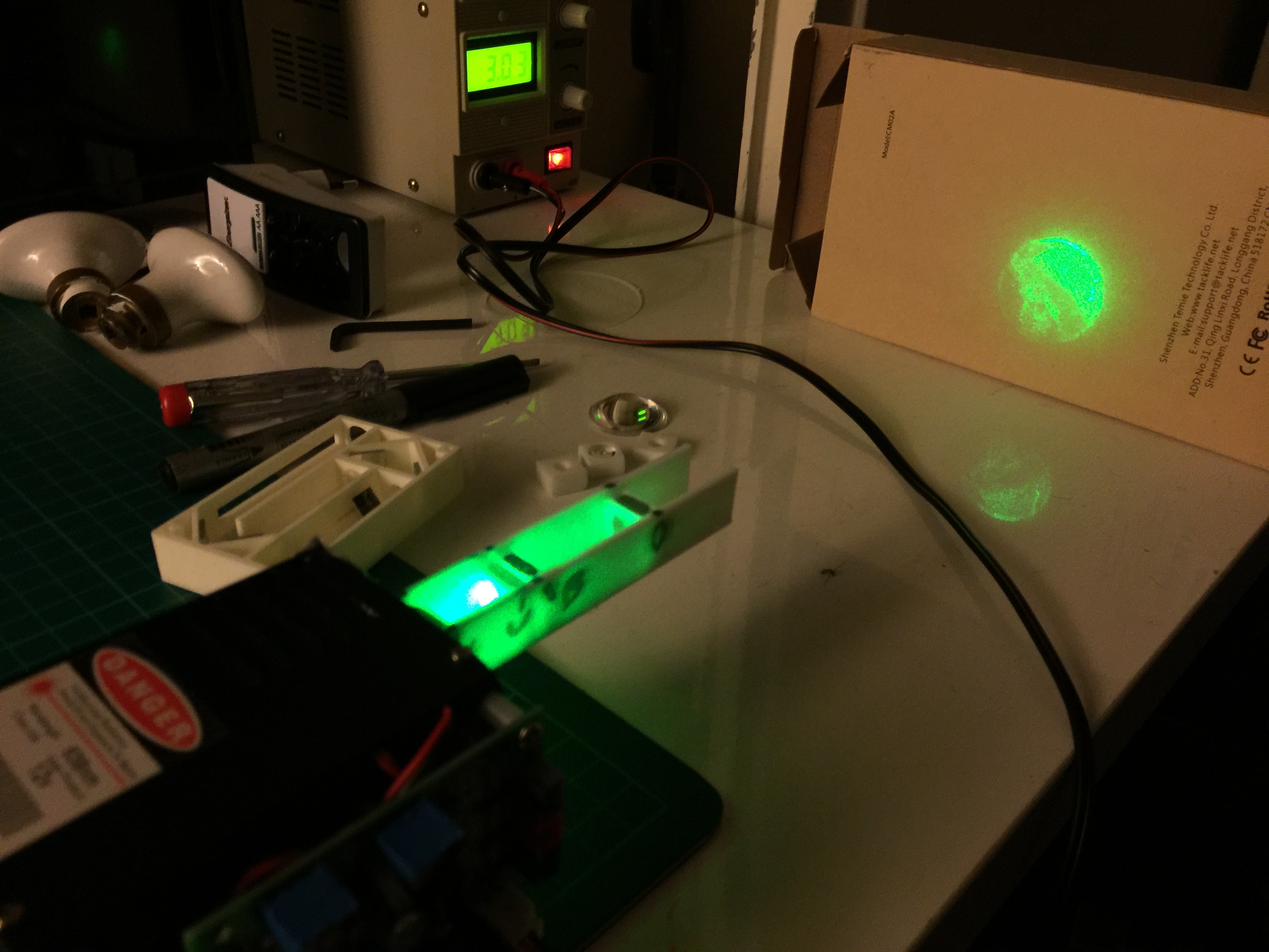

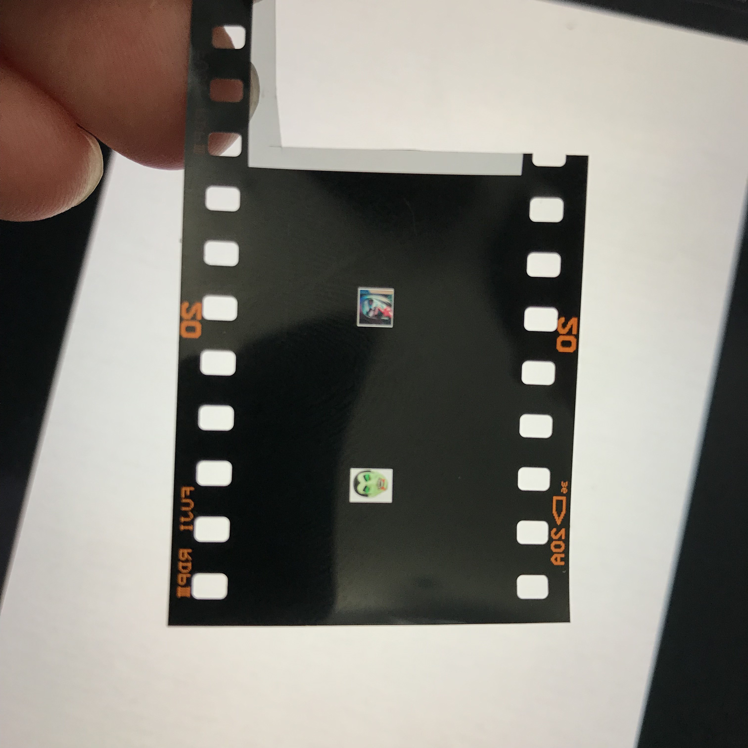

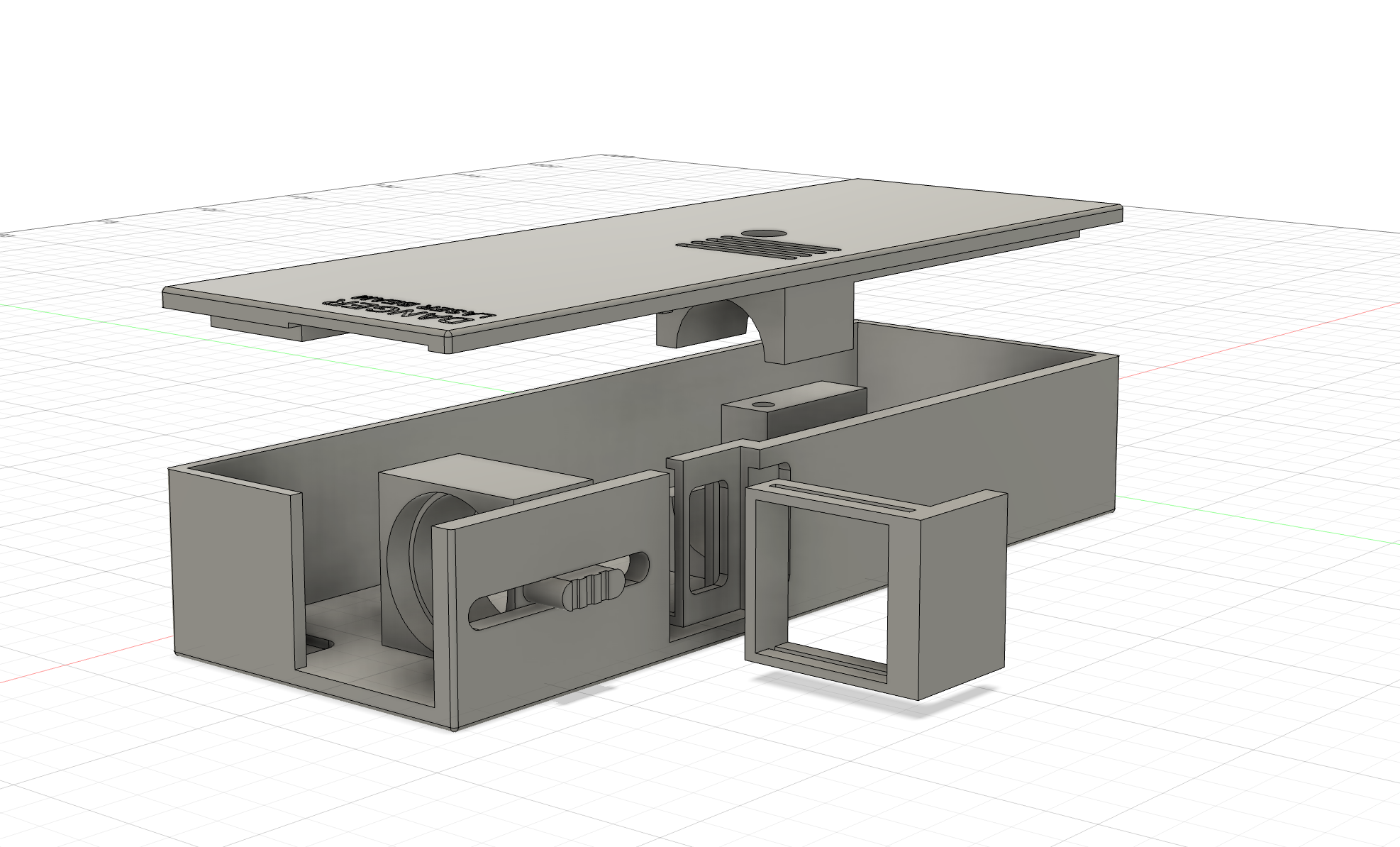

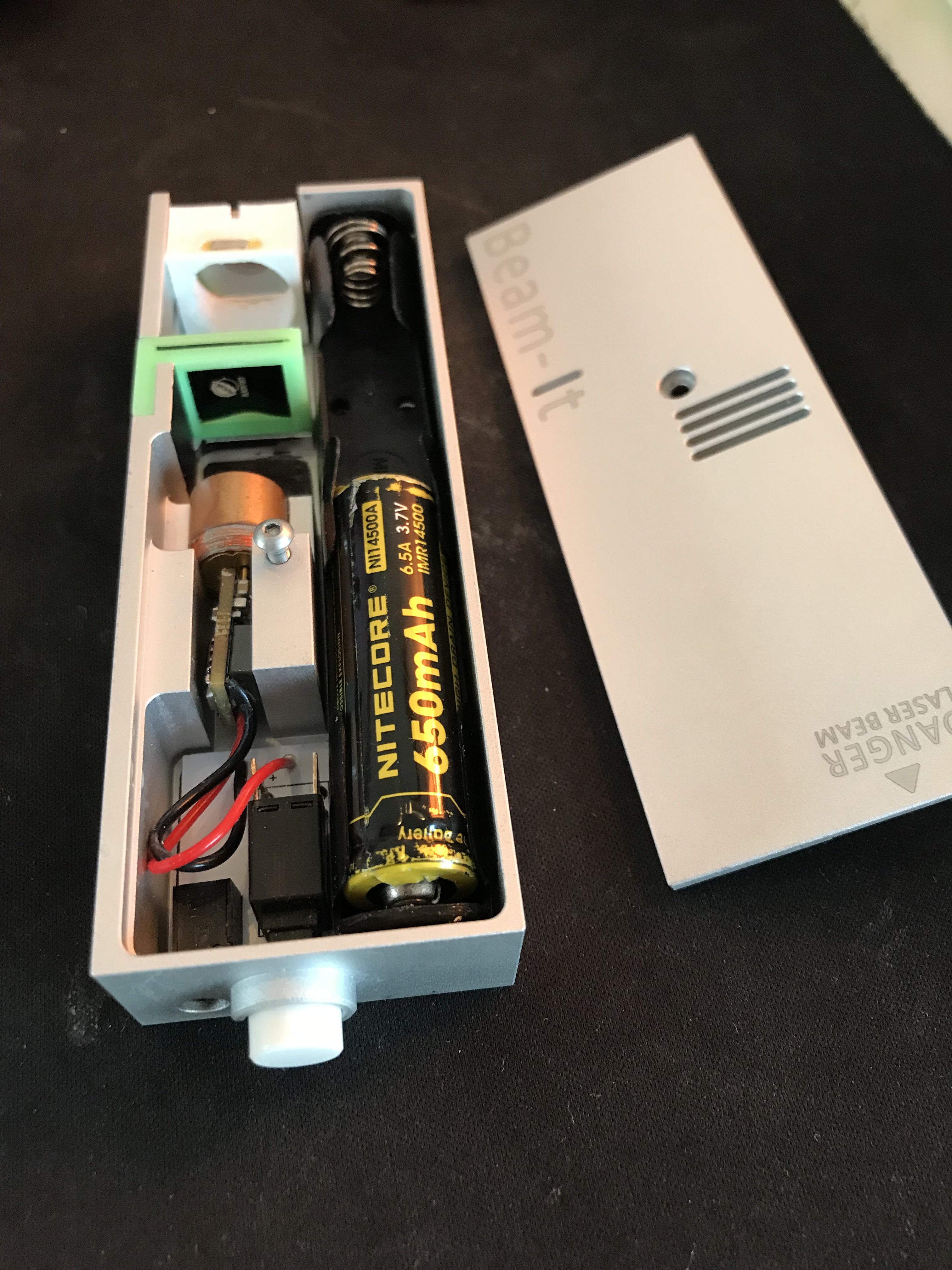

In a nutshell, this is a handheld laser projector. The laser bounces off a few mirrors before passing through film of the message to be projected by a lens. Both can be repositioned to tweak size and focus.
Spec:
-1 watt laser diode
-laser driver with protection (over-heat)
-rechargeable by micro usb (capacity / power)
-case cnc aluminium anodized and sanded with heatsink incorporated
-battery circuit protection
-focus lens laser
-ir filter
-distance 5m to 100m

Would an LCD with the backing removed work well in place of the static slide?

Shih Wei Chieh wrote 09/07/2018 at 05:56 point
what is the reason to extend the laser path longer? thanks.

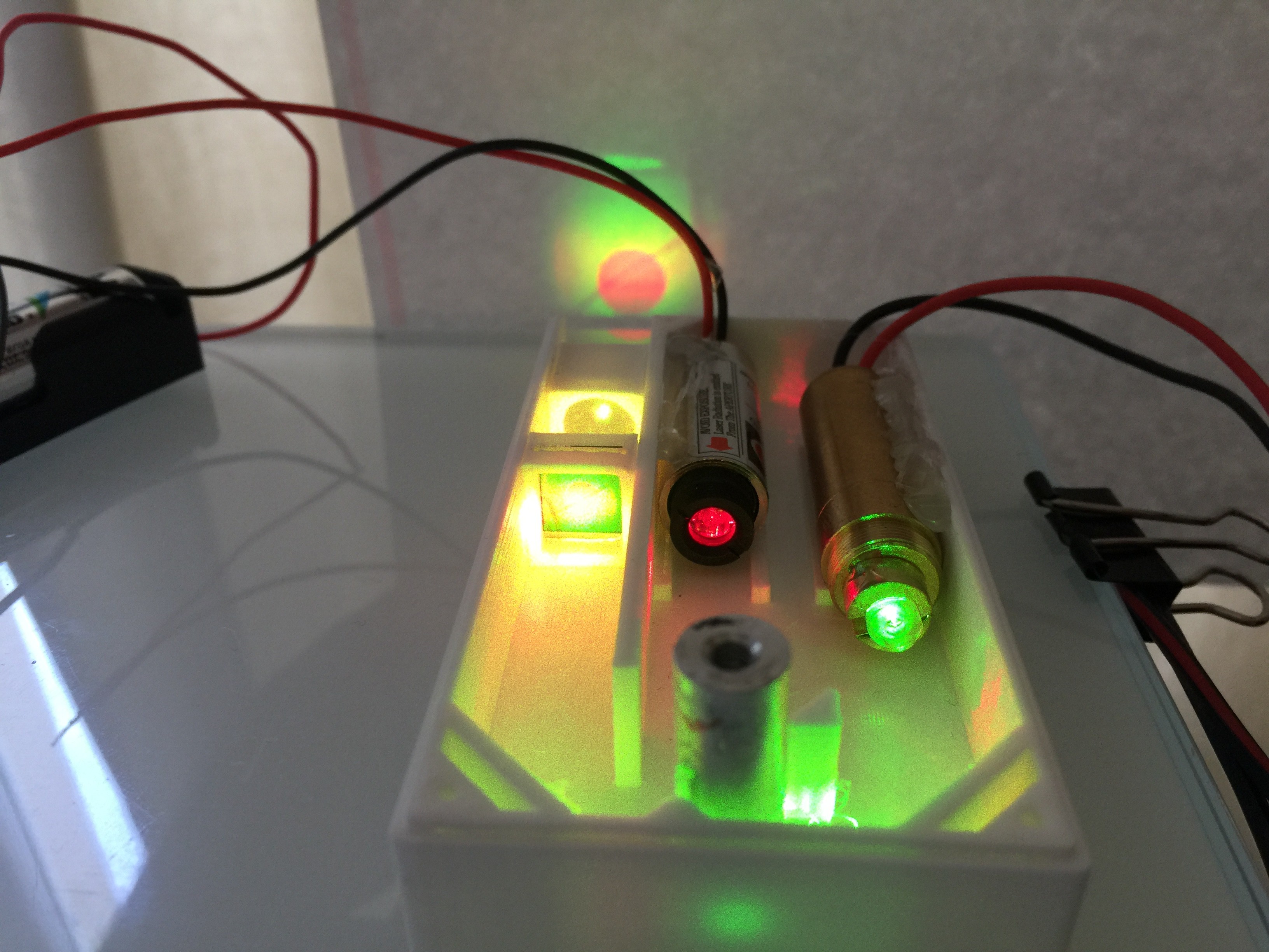

Ah, now this is a cool idea! I wonder what adjustments would need to be made for different colors of laser.
Speaking of which, you should look at a dichroic crystal to combine different colors of laser, shone through different images (same image, representing a different color channel) for a full color projector.
