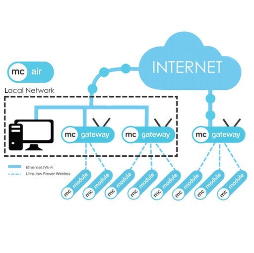

How the platform works:
The mcThings platform includes 2 main components: mcModules and mcGateways. A powered and connected mcGateway creates the mcAir network (up to 200m range under optimal conditions) and bridges the information between the mcModules (within range) to and from the Internet. Using the IDE (mcStudio) and mcScript (ultra-low power programming language - a subset of VB.NET) allows you to wirelessly connect, debug and program modules with your customized scripts.
Note: You also require an mcDongle to complete firmware updates on the modules/devices and gateways! We recommend looking at the mcModule120 Dev kit which includes everything you need to get going!

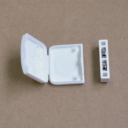

Using the Reed switch
Using the mcModule enclosure, you can easily install the module to a door/window/etc and place the magnet clip so that it lines up with the module when the object is closed. You can also use your own magnets! We recommend a strong magnet like neodymium. If you are building a customized enclosure or have a unique object that you want to use the reed switch with, this is a good option.
mcModule enclosure w/ magnet clip
mcMod120 in enclosure
