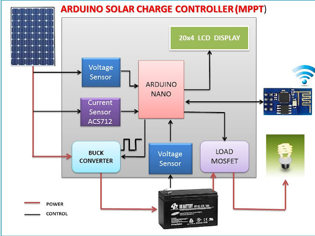

Specification of the project
1.This project is Based on MPPT (Maximum power point tracker) algorithm
2. LED indication to show the low mid and high level of charge stat
3. LCD (20x4 character ) display for displaying power,current,voltages etc
4. Lightning /Overvoltage Protection
5. Protection For Reverse power flow
6. Overload & Short Circuit Protection
7. Logging data through WiFi
8.Charge your Cellphone, tablets any gadgets through USB port

Model of Arduino Based MPPT Algorithm Charge Controller
