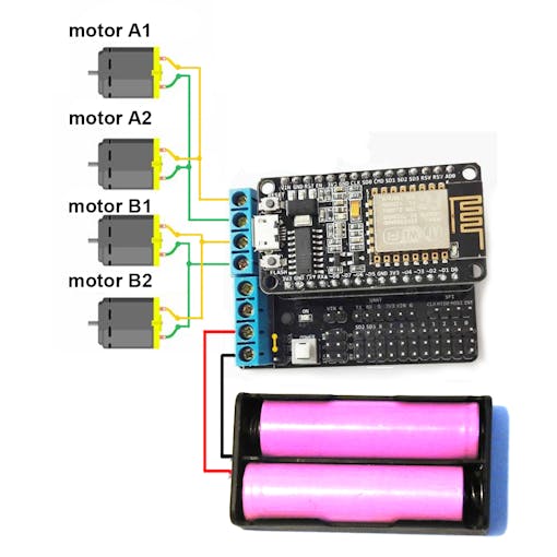

Circuit
That's how I connected all this stuff. For power supply I use 2 Samsung INR18650-30Q connected in series. About motors, I connect 2 motors in parallel to each motor outputs- PWMA(Left side), PWMB(Right side).Make sure that motors will rotate in one direction when you connect it.

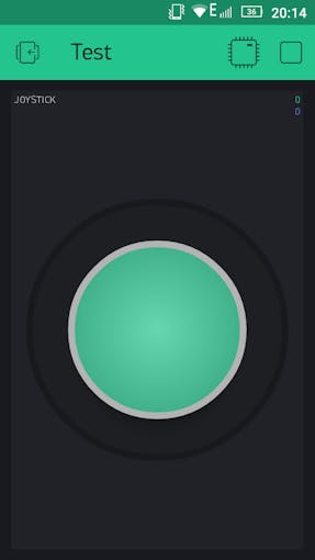

Blynk application
In Blynk application we need only joystick.

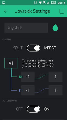

Joystick settings
Set joystick to merge mode for work with Virtual pins. Values for both axis from (-1) to 1.
