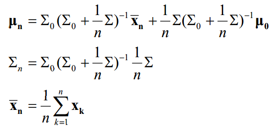

We construct the model using the parameters below (where μ is the mean of the data and Σ is the standard deviation of the data):

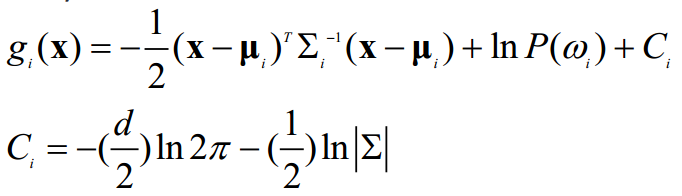

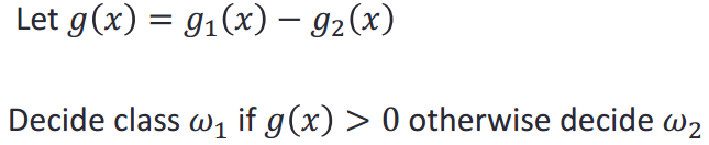

Now that we have the model above for both good music and bad music, we can use a decision boundary to detect what kind of music you are listening to at each data point.
where:

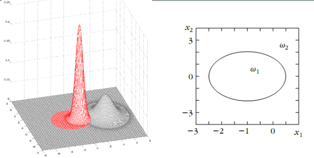

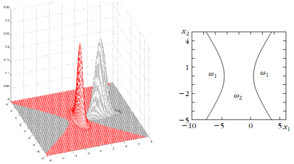

The boundary will be some sort of quadratic (hyper ellipsoid, hyper parabola, etc) and it might look something like below (though ours is a 10 dimensional function):
