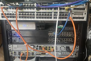

I recently moved to a new house in a new town with a new job, my immediate thought was to set up my computers right this time (instead of the one overtaxed desktop I had running multiple VM's to serve the LAN with various services.) To accomplish this I'm going to connect 6-7PCs + miscellaneous devices to a main server where I will provide tor'd or regular connections, home security services (via zoneminder), automated backup capability (via rsync), limited media hosting (probably plex), vpn services (Open VPN), and kernel virtual machine capabilities to allow for thin client network boots. This is clearly a long term project but one I hope the best for.
This will be a two sided project with both a Hardware and Software Segment but I'll start with hardware first.....that's all for now, more soon to come.
(Pictured in the description is a great bit or wiring which is not mine, but still is awesome and was better than a blank pic.)
