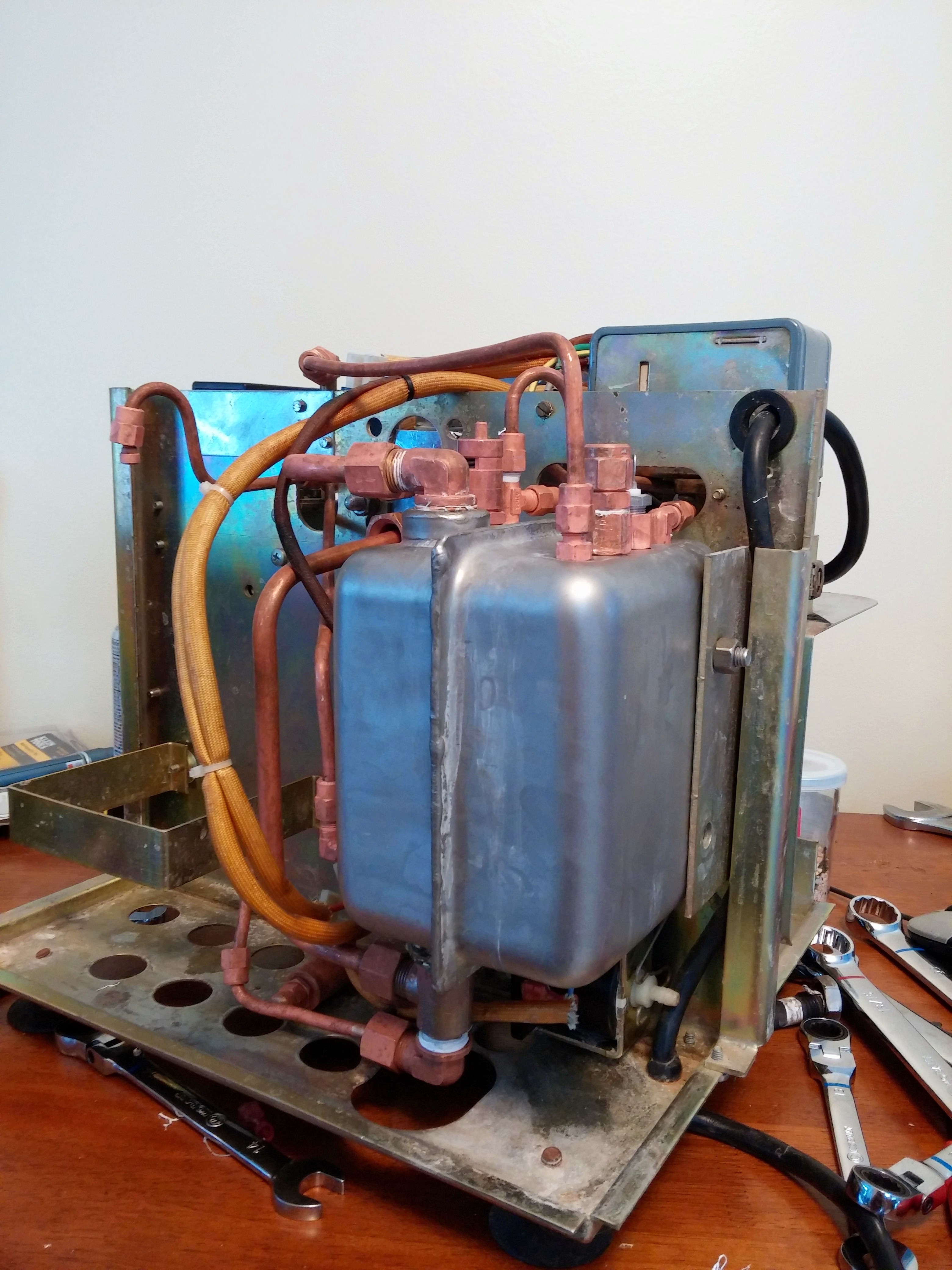

    Now that the machine is completely clean, I had to reassemble it. Thankfully, I took a LOT of photos. It's a simple device, but many of the copper pipes look quite similar and are not the same. I forgot to take a photo of the whole thing back together, but here's most of it. I'm going to clean up the case at a later date and probably paint it, but at this time it was -20 degrees F outside, and so paint would likely not dry. So for now I'm just making sure everything works. Surprise, it does work. The steam pressure on this thing is impressive.

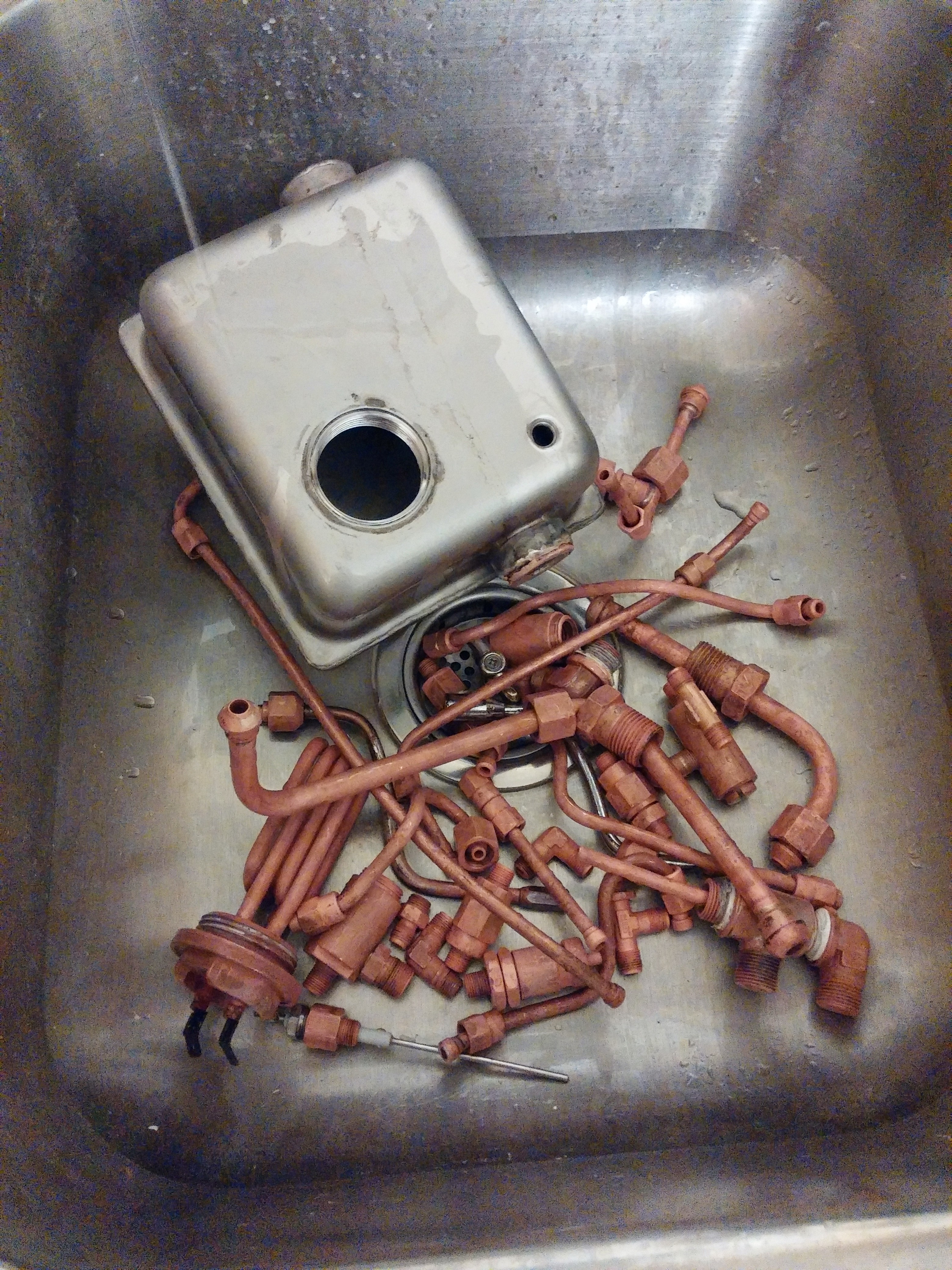

    The first step was to clean up the components. This machine had been sitting with water in it for quite a while. There was a lot of scale buildup that needed to be cleaned up before I was going to taste anything that came out of it. So, I disassembled the whole machine and put all of the parts in a bath of hot Citric acid for several hours.
    It came out very clean. You can see at the bottom of the heat exchanger where the fitting has become detached due to a failed weld. This was the culprit of the leak, and was easy enough to repair myself without having to buy any parts.

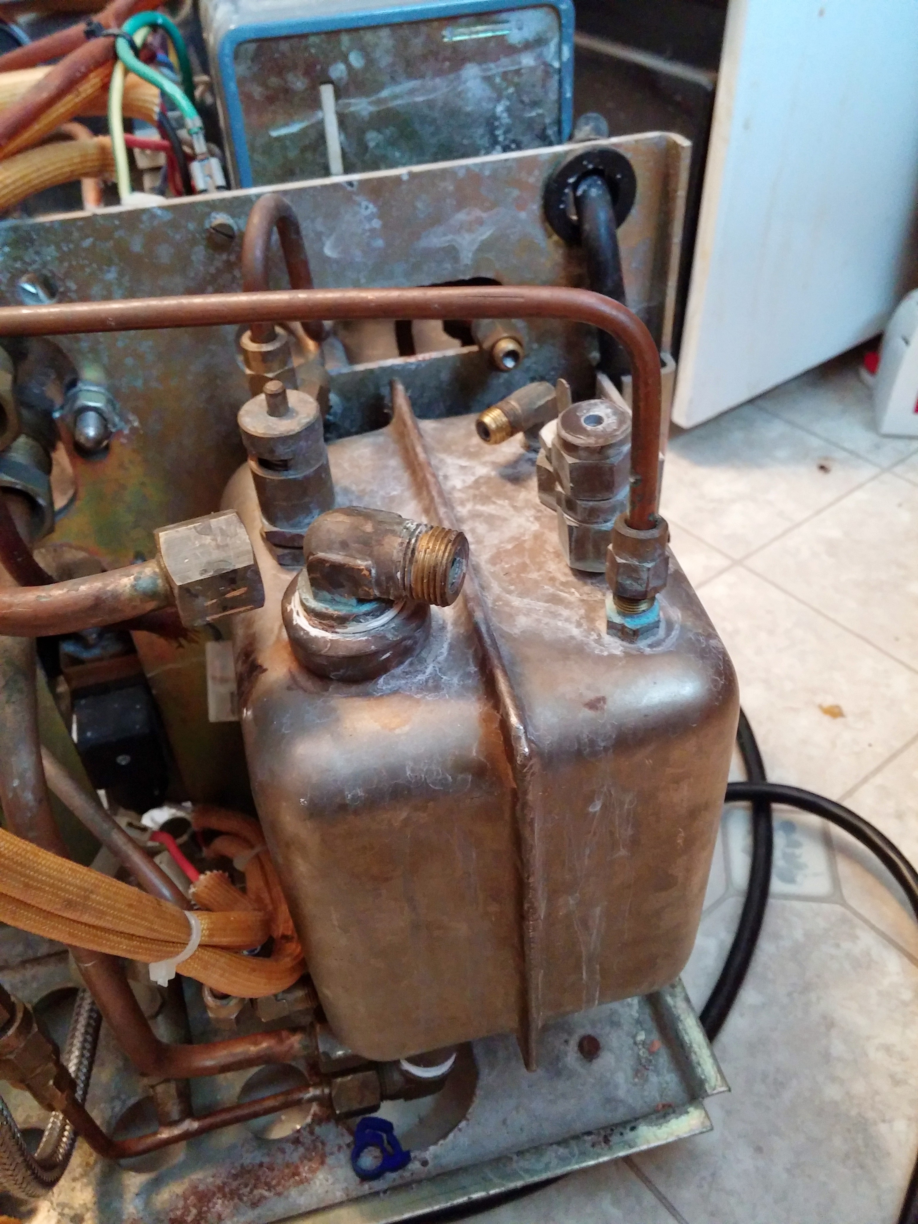

    The project started as a way for me to learn how an espresso machine works, and also taste some good coffee. Espresso machines that are worthwhile tend to be quite expensive. However, as with many high end kitchen appliances, it's not a very complicated machine. In fact, it's mostly a pile of copper pipes, a heater and a pump. The entire thing is controlled by mechanical switches and every component is 120VAC so there's not a diode in the entire thing.
    This is good news because it means that if you can wire a switch, and braze copper pipe, you can probably fix an old espresso machine, and even if its discontinued you can make new parts with standard plumbing fittings and basic electronic components.
    I purchased my machine on eBay very cheaply. As in scrap metal cheap. It's an old machine and the owner didn't really know how it worked, and it was leaking from the heat exchanger. Unfortunately they don't sell that heat exchanger anymore. The machine is a Mini Wega from the 1990s (very similar to, but not to be confused with the Wega Mininova). A used one in good condition is about $2,000 last I checked, so it was a worthwhile project to see if I could get it working again. Here's a photo of what it looked like.
