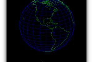

3D dungeon crawler in C
An experiment in simulating 3D effect in C
A pointless exercise in C programming, yet fun.
Dcrawl2.mp4
video of revised version.
MPEG-4 Video - 13.67 MB - 03/10/2018 at 16:50
Download
Dcrawl.7z
Zipped compiled .exe file of the game
7-Zip - 8.72 kB - 03/10/2018 at 16:34
Download
Dcrawl.cpp
Updated Version, better code, broken down into functions for simplicity
cpp - 43.42 kB - 03/10/2018 at 16:32
Download
Dcraw Vid.mp4
Game play video
MPEG-4 Video - 11.90 MB - 02/21/2018 at 14:19
Download
Dcrawler.7z
compressed .exe file of game
7-Zip - 8.31 kB - 02/18/2018 at 21:28
Download
View all 6 files
Igor wrote 10/18/2021 at 16:29 point
Hi Bonez,
Great art! I would like to ask you permission to port it for my #CRISS CP/M 8-bit Homebrew DIY Computer (AVR based) project. To do that I need to reduce it to 25 lines, hope that it will look also fine.
Bonez wrote 05/22/2023 at 14:40 point
srry for the late reply, have not logged in in a long time, but by all means,, go for it!
bert.hoogenboom wrote 10/14/2020 at 17:47 point
Its not so much the gamplay but the how you do it (ascii) nice old school
MagicWolfi wrote 03/22/2018 at 01:30 point
This is brilliant and might just be the thing to make my prediction come true. With your permission I am going to port the code to Arduino and run (sort-of) Doom on my video display shield.
https://hackaday.io/project/21097-ntscpal-video-display-shield
Bonez wrote 03/22/2018 at 20:01 point
go for it, if you pull it off, send me a copy!
STEAL-THIS-HARDWARE wrote 02/20/2018 at 13:02 point
like Pathways Into Darkness but ASCII, neat!!
Mike Szczys wrote 02/20/2018 at 03:52 point
Looks neat, moar info?
Bonez wrote 02/21/2018 at 03:41 point
it is just a cheesy game, I had the idea to use still frame images run in a loop and use system("cls"); to give the illusion of 3d by clearing each frame before the next, like a flip book. The rest is just random dungeon generator with random enemy encounters, leveling and eventual dragon slaying when all the treasures are found. Far from finished but it is playable, just download and run the zipped .exe file.
