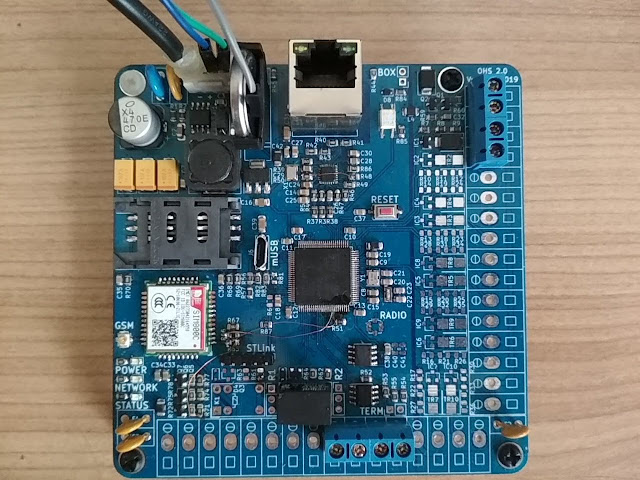

    Over past few months I have prepared new version of OHS gateway called simply 2.0.4. It is new iteration of my 2.0 version fixing layout defects and integrating new features. Here are the specifications:
    • STM32F407 with 1GB of flash and 128KB + 64KB CCM of RAM, running at 168MHz.
    • LAN8720A Ethernet PHY with 10/100Mbit.
    • Two step power supply with 12V to 3V8 switching and 3V8 to 3V3 LDO.
    • Battery for RTC CR2032. STM32F407 has on-board RTC.
    • 10 analog (balanced) inputs for PIR, smoke, ...
    • 4G SIM7600x module
    • Radio module for RFM69HCW, or alternatively RFM95.
    • 128KB SPI FRAM.
    • RS485 for wired connections.
    • 2 relays for sirens.
    • 1 tamper zone for enclosure.
    • Micro USB port.
    • ST-LINK V2 port.
    • 3 LEDs.
    The main changes is GSM part, which now sports 4G/LTE modem from SIMCOM SIM7600x, and double the FRAM capacity.
    SIM7600x is decision that I've been thinking about for some time. On one hand the module is quite expensive compared to 2G modules, but on the other the 2G is becoming phase out in many countries. It is quite a dilemma, but I decided to invest into module that will have long life expectancy. There are always more difficulties. One is that the hardware needs to be able to speak with 1V8 logic presented on module, which I have solved by adding MOSFET level shifters. And second, that the module is bigger, and I neede to place it on the back of PCB. I have also removed the mini SIM holder, and replaced it with smaller and more up to date micro SIM.
    There are several versions of SIM7600 module. One global, most expensive, that is supposed to work in all regions. And the regional ones for Europe, North America, South America, Asia and so on.
    FRAM size has doubled for the reason to store some larger data needed conveniently.  First half (64KB) is used as before to keep 4096 log entries for gateway logger. Second half will be available to several new functionalities I plan to add to gateway software. I was also tmepted to add a uSD card, but it is easier to store data on synchronous SPI FRAM, then to access uSD with file system that can be damaged or not present. Not to speak about wiring.
    Other changes not so visible are RC circuits on battery and power signals of UPC. These are nicely filtering out the spikes that are sent to gateway, eliminating the need for software compensations. Without them the gateway has wrongly reported AC power OFF signal.
    Also there is now a shotky diode, to add polarity protection to RTC battery.

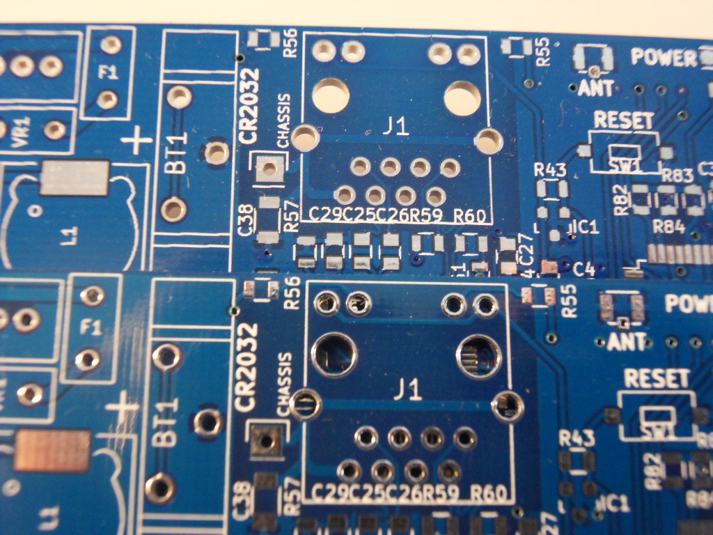

    It is always nice when someone appreciate your work, especially if you give the product to public as free to use. It happened to me as well, I was asked to review a PCB fabrication house called pcbway.com. Without too much hesitation I have sent them Gerber files of OHS gateway, and two of weeks later postman brought me the package, nice :).
    I must say I have tried around 4 different China fabrication houses, and this one is fifth. I tend to do my board easy to hand solder, and I do not use fine traces or gaps bellow 10mils. This give me better trust to choose rather inexpensive manufacturing processes. There is not too much difference between ordering in pcbway and other houses, you do all as usual on their web pages. One difference though, is they probably inspect the gerbers by person. It came to me as I have used 6mil trace/gap option as the basic available, and within 1 day after submitting gerbers they proposed me to change it to 5mil. First time I've seen that actually someone had a glimpse of my layout before manufacturing. Of course it was a little more expensive, but still within the free coupon I was given for review.
    The boards themselves are nicely made. I can compare to 2 other PCB houses I have boards from. I will skip the traces evaluation since I have no visual or other tool to do any reasonable comparison. But first think you notice with bare eye is silk screen, it is noticeably vivid and precise. It's placement is usually the weakest point in China PCB houses. But this board is done accurately, not faint and not smeared. I think using this fab one can afford to put logo on silk screen and not be afraid that it will come out ugly.
    Second difference is via placement. When you use IC with many legs you usually route signals to other IC close to each other, this leads to having vias sit to each other in some pattern too. On such patterned vias you can easily spot the sharpness and bit placement. I must say there the vias on the PCB are great I would not be afraid to go with lower then my 0.3 millimeter.  Along with via quality goes actual hole placement. And it is similar to vias, nicely placed in exact center of pad.
    Third difference I've noticed is solder mask, using loupe the mask is somehow more corresponding to what is draw in gerbers. Put it simply, exposed copper pads are smaller and more precise. This will help especially during soldering, the small components will not wander around, and IC will not have as many solder bridges.
    Here is picture hopefully supporting my point, with pcbway PCB closer on top overlapping seeedstudio PCB. You can see here of-centered holes and wider solder mask along with nice silk text.
    As I said on beginning, I do not develop over-complicated PCBs with many layers, buried vias or impedance control, so my evaluation is as erudite as hobbyist can offer. But I would say I will use the pcbway services in future for sure.
