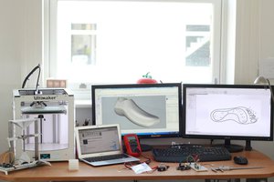

The non-circuit hardware tasks have also been advancing in the past few months. Here are some renders of the casing parts...
...and the digit mold for the sensor package...
