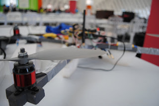

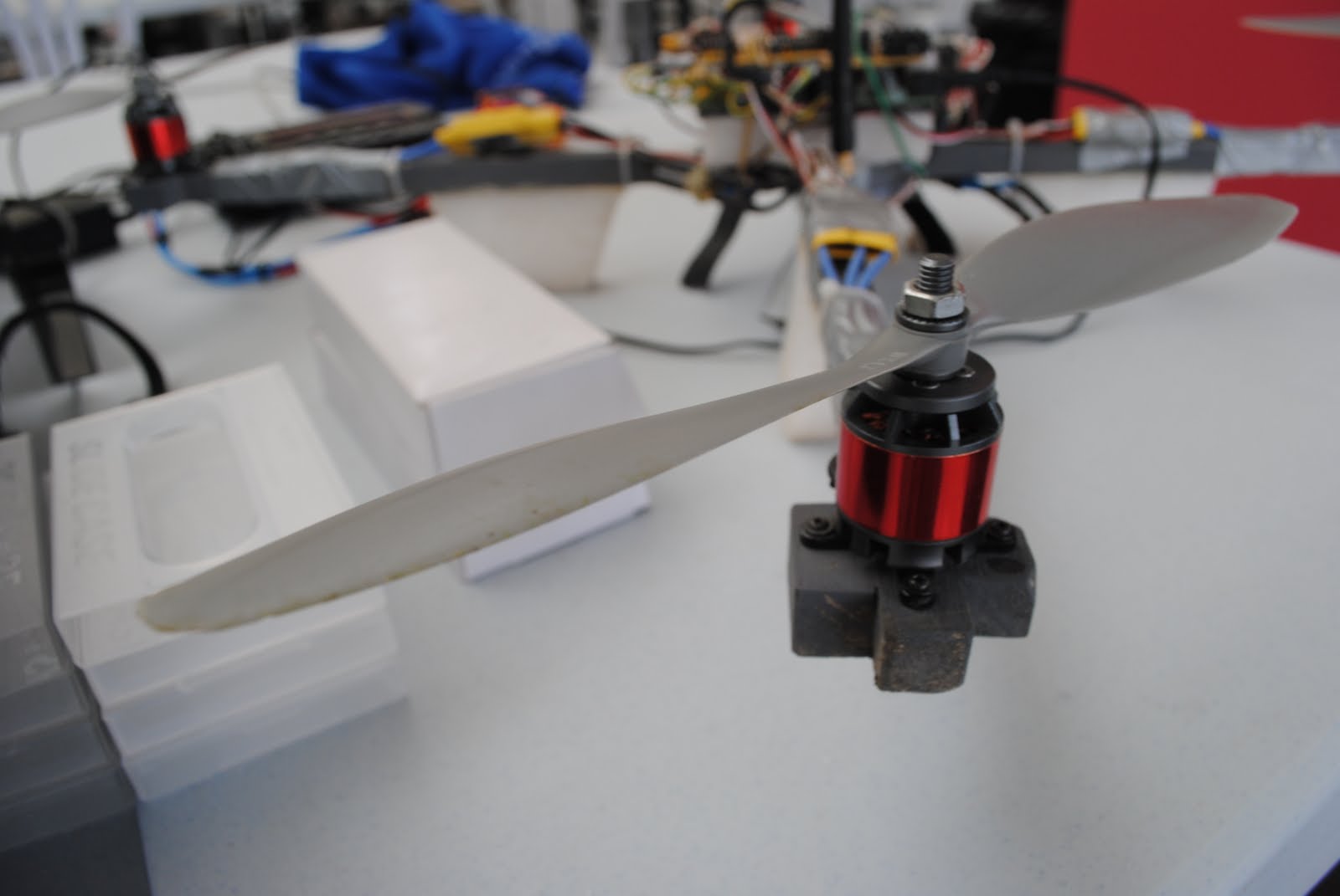

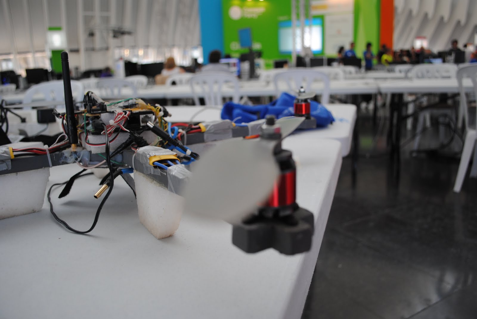

Quadcopter Atropos is the concept evolution of the rover texas Ranger. It has all the tweaks of the rover but also many other features, required to make it work. Also made with wood and paper, the only bought parts are the motors, controllers, battery and blades.
Atropos is based on OpenWRT La Fonera 2201 router. It is auto-stabilized by a entirely home made Inertial Measurement Unit, using Wii console controls.
In order to mantain minimum hardware components, attitude sensors (Wii motion plus -gyroscope- and Wii nunchuck -accelerometer-) are connected directly to the router using the LED lines. LED Lines are used as software emulated I2C ports.
