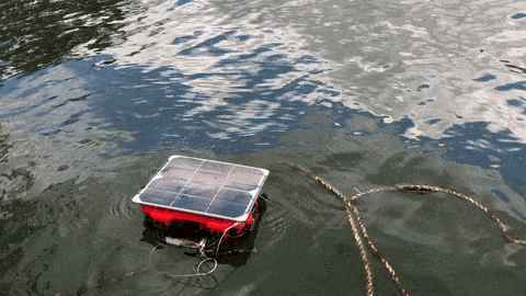

Aside from demonstrating an IoT use-case of Voltaic's mini solar panels, the idea was to create a self-sustaining, off-grid device that could track water quality for the long-term and make its measurements available to the public.
Voltaic expressed they wanted to track temperature, electrical conductivity (a metric for salinity and dissolved solids), and dissolved oxygen, and periodically send these data to a public cloud database called AdafruitIO. Because power would be supplied by a solar-charged battery, the device should enter a low-power sleep mode between measurements or if cellular network connection could not be established.

Weatherproofing and Deployment
It Eventually, the device's various components were all working harmoniously: taking accurate measurements, transmitting them to the cloud, sleeping regularly, and consuming very little power. Before depositing...
