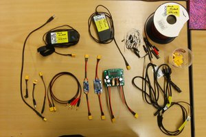

  • A few specs
    Marius Taciuc • 03/23/2018 at 00:14 • 0 comments
    Product specifications

  • Added schematic
    Marius Taciuc • 03/20/2018 at 04:20 • 0 comments
    I added the schematic in the Files area. I also made two quick renders of the layout files. One of the layout files is including the connector and the other one is without.
    As you noticed, it is not so much of an electronic design, excepting the fact that I redrew the diagram with my own connectors, reverse polarity protection diode and the LED light. In fact, I believe there are similar products on the market at this time. After all, this simple schematic is like connecting an LM317 to a couple of capacitors. It's only requiring basic skills. This simple diagram is proposed several times in different configurations in the datasheet of the component. It is a simple circuit but it will work perfectly with my design.

Clark wrote 08/25/2018 at 15:15 • point
I had a same project like this 3 years ago using LM2596, only I'm using 2 stainless steel screws. It is sturdy and always come in handy during camping. Good luck
mirosan wrote 07/16/2018 at 12:29 • point
Hello Marius, great work! It's going to help a lot of people.  One thing I want to raise with you is unless you implement the usb charging negotiation/signalling the phones will default to the slowest charge rate. This can be ridiculously slow. It need not be complicated... have a read of this project that made this in a back to back usb dongle.... http://obddiag.net/usb-power.html
All the best
Florian Festi wrote 07/12/2018 at 12:09 • point
You may want to look into laser cutting for the case. It can probably be made out of a few layers stacked on top of each other and then held together with screws. It might be enough to just use a few cross sections from the 3D model you already have for 3D printing.
While laser cutters are less common they are much faster than 3D printers and you can cut out such a case in like two minutes - if not less.
Marius Taciuc wrote 07/12/2018 at 03:21 • point
These seem to be good ideas. Thanks
Brian Scoggins wrote 07/10/2018 at 19:34 • point
Have you considered e.g. terminal blocks in addition to or in lieu of the cable with alligator clamps? I'd be concerned about cable lifespan if I was using one of these in the field for extended periods of time.
Also, have you considered redesigning the circuit to use PTH/through-hole parts so that anybody with access to the PCB, the components, and a soldering iron could crank one out? That seems like a quality intro-to-soldering project that isn't just a blinking led that sits on a shelf somewhere.
