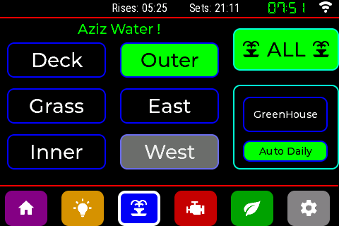

Anyway, this is what I’ve managed to get the graphics looking like on a very cheap 4 inch TFT 480 x 320 with touch with only 160 lines of Berry code and 85 json lines for 6 pages of content & controls.
And a very simple clam shell enclosure finishes it off.
In the box we have:
Dev Board: ESP32-S3-WROOM-1-N8R8 quad 8M flash, octal 8m PSRAM dev board flashed with Tasmota (LVGL-Haspmota version)
Display: 4 inch TFT 480 x 320, 16bit RGB, SPI, ST7796U, touch XPT2046
Sensor: BME820 Atmosperic
