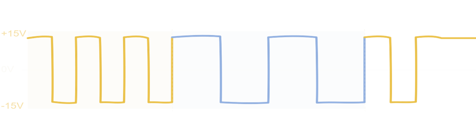

    The Americans later decided to adopt Lenz’s DCC and establish a worldwide standard, which led to the NMRA association publishing the standard. But engineers love complicated things (otherwise what kind of engineers would they be!), and DCC is the result. In practice, commands are sent as bits to the address of a decoder on board a locomotive, and these travel over the track power as a square wave: a 0 must last 100 μs, a 1, 58 μs.

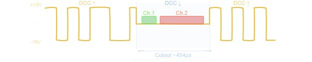

    At some point hobbyists said: we want more — feedback for DCC, which was originally one-way. When we program one of the functions (for example braking inertia) we want to know whether the value has been written or not. Once again Lenz Elektronik developed Railcom, later approved and adopted by the NMRA. Railcom is brilliant, but complex. DCC compatibility could not be broken, so a clever workaround was devised: for a very short time window (453 μs) called the cutout, the DCC command station stops transmitting and short-circuits the rails. At that point the decoder on board the locomotive hears the silence and starts talking, sending the requested value through a tiny current of at most 30mA. This means the hardware must capture this tiny current, filter it, convert it into 0/1 and pass it to a fast UART. At that point the DCC command station knows how to interpret the message.
    Here is what a DCC waveform looks like with the cutout and the reply sent by the on-board decoder:

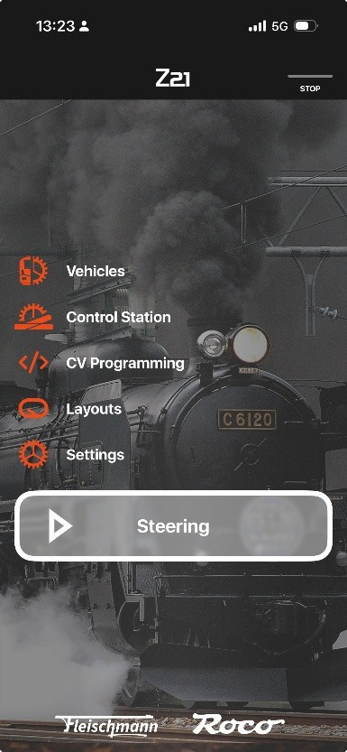

    But today a DCC command station is nothing without remote control. In the model railway world, one of the best-known manufacturers of digital trains is Roco, which has its own sophisticated control system called Z21. It is so popular that they published the UDP protocol that lets a phone control the trains through the DCC command station.
    The Z21 specification has been made public here: https://www.z21.eu/en/downloads/manuals
