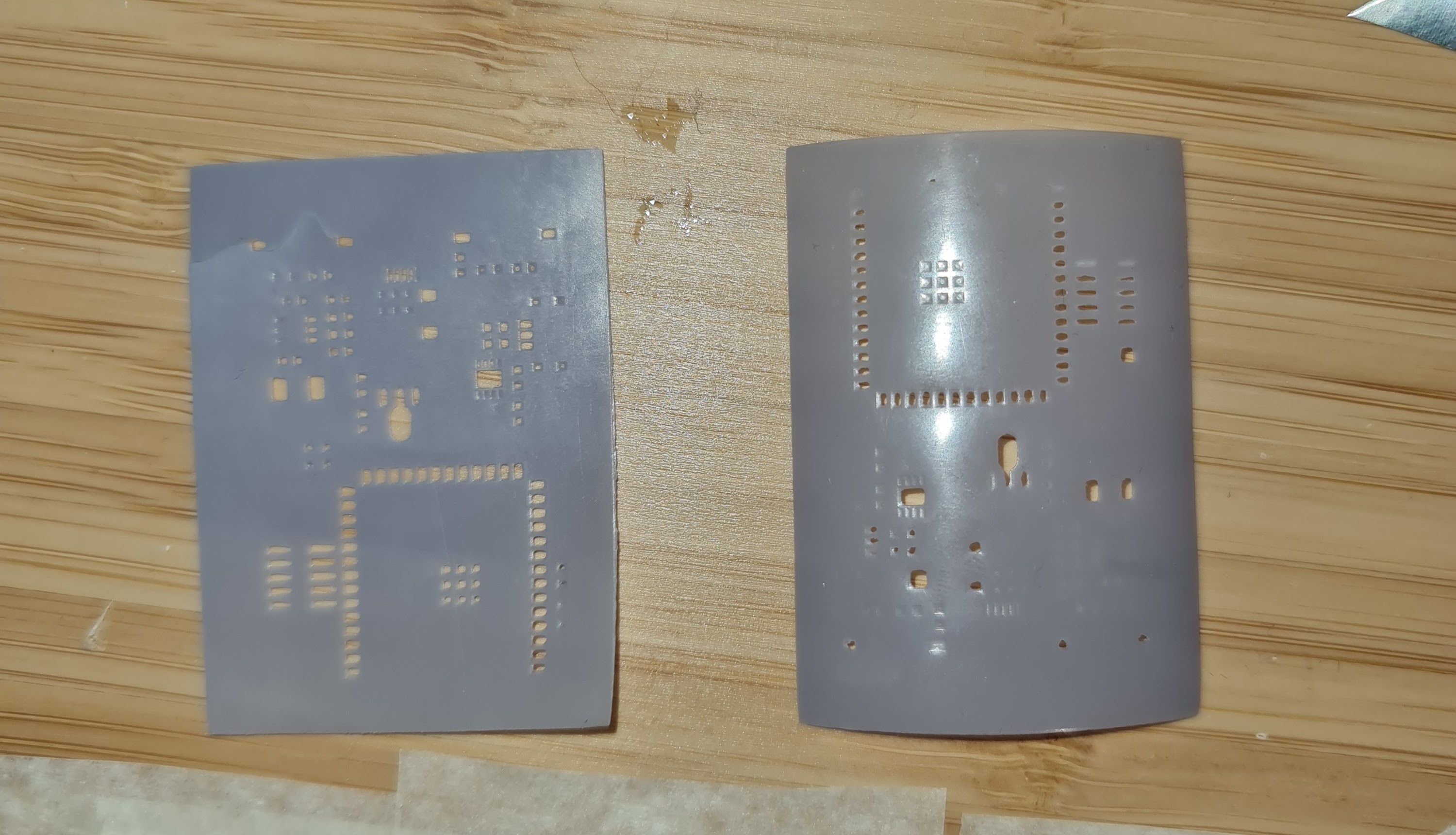

    Printing the stencil
    To print the stencil, import the model into your preferred slicing software and adjust the settings. It is crucial to fine-tune the exposure time to achieve the desired results. Too much exposure will make finer details appear solid and clogged, while too little exposure will result in poor adherence to the print surface. Keep in mind that, due to the stencil's thinness, you may need to adjust the bottom exposure time.
    After printing, it is recommended that you clean the stencil under running hot water. You do not need to be gentle when cleaning, especially with the smaller details. Other wise they endup clogged
    My Attempts
    On the right: 40 seconds exposure. As you can see most of the holes are solid and the squares are more rounded.
    On the left: 25 seconds exposure. Most of the finer details are visible, but still clogged.
    My final attempt was a succes with an exposure of just 5 seconds.
    Not bad

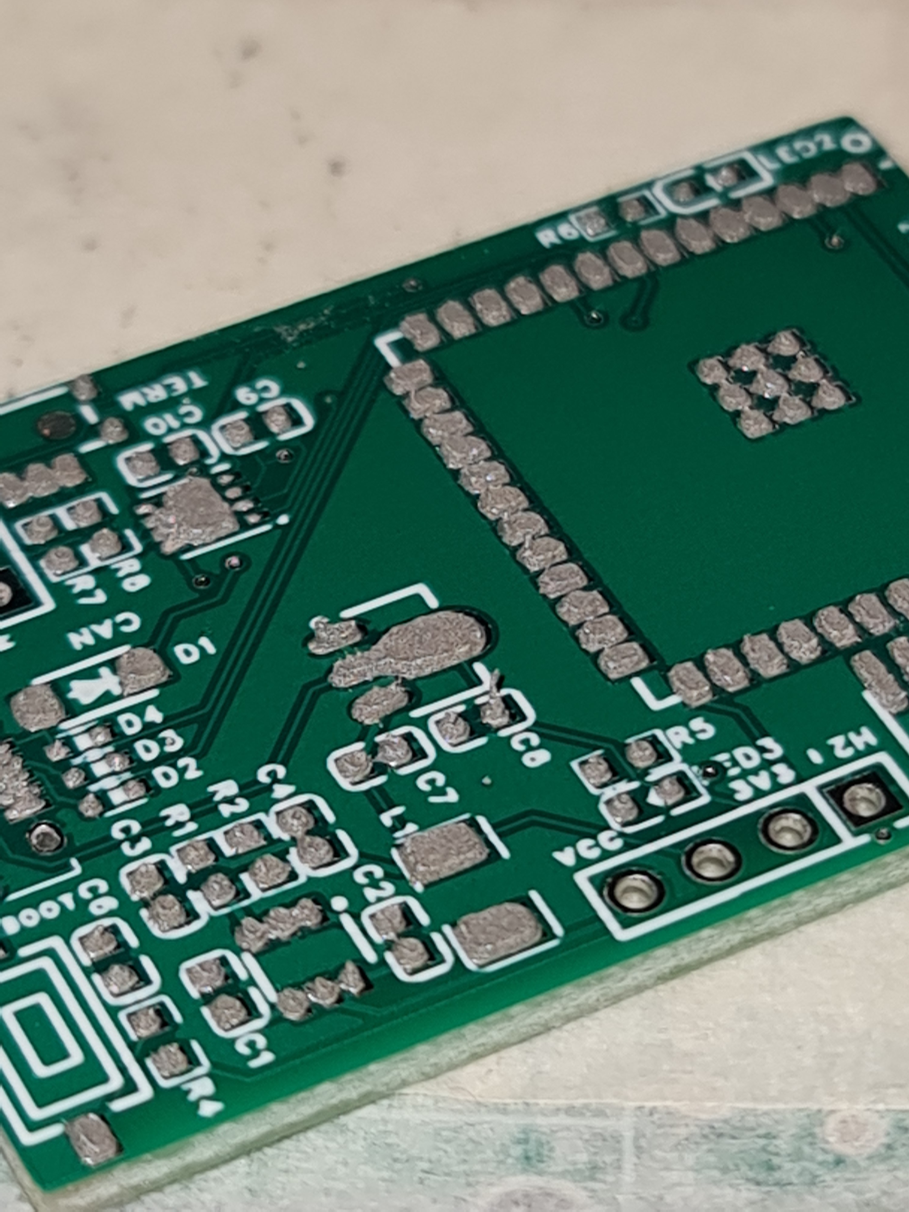

    Final thoughts
    I think the 0.12 mm is a little bit too thick, because after melting the solder without components on it, it made a lot of smaller pads like the micro usb ones ono big blob.
    Also, the flexible nature of such a thin piece of partially cured resin doesn't help either. The paste spreads out under the stencil and also sticks too much to the stencil. Maybe curing it between 2 peices of acrylic or something else would help.
