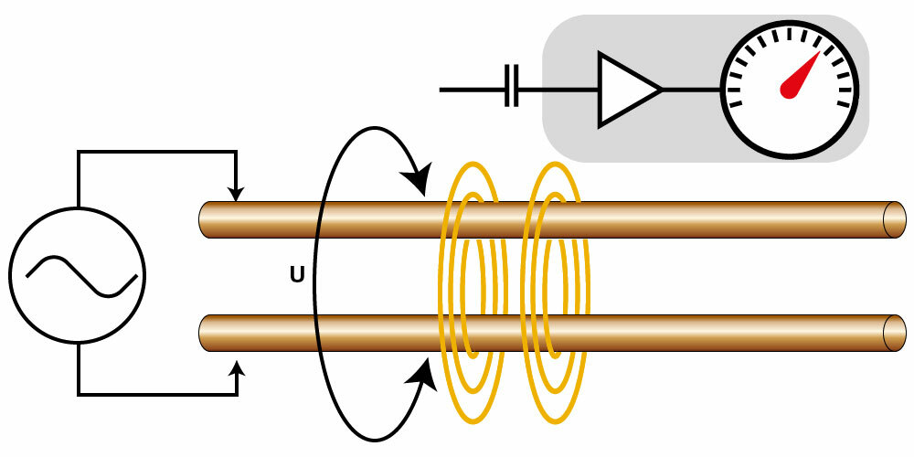

The cable locator receiver needs at least one sensor to "pick up" the electromagnetic field. This can come in the form of a whip antenna (capacitive sensor) or a coil (inductive sensor). Both have specific advantages and disadvantages. Therefore, some devices have one or even several (two or even three) replaceable sensors. The signal that they receive is amplified and processed. The resulting processed signal is presented to the operator.
The signal can come from either a voltage or variable frequency current generator (200 Hz - 130 kHz). Some generators have a single fixed frequency. Others have multiple range of operating frequencies (up to 4) that can be chosen based on the use case. Some generators can generate a signal of several frequencies at the same time. And in some cases two frequencies may alternate.

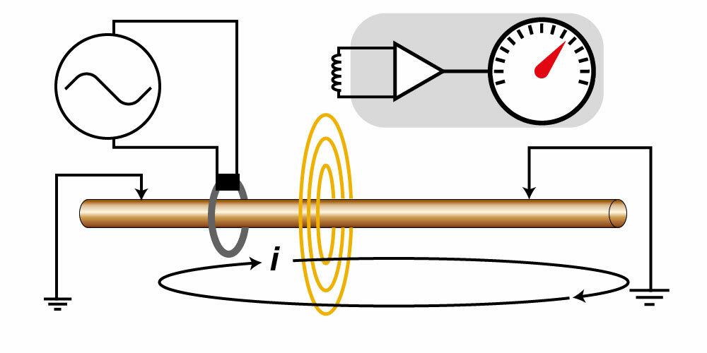

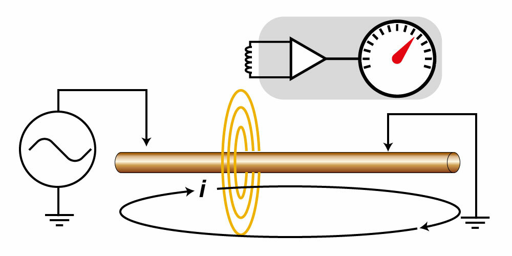

In active mode, the signal can be sent to the cable via several different methods. The generator's signal can be sent directly to the cable (direct connection), via an inductive antenna (remote antenna) or through an inductive coupler (signal clamp).
The direct connection method is self-explanatory. The transmitter must be physically connected to the cable that's being traced. However, if this is impossible, one of the other two methods can be implemented.

Unlike an inductive antenna, an inductive coupler (signal clamp) only sends a signal to a single cable. Therefore, connecting to cable conductors is not required. However, using this method is only possible give that there is access to the cable itself. Let's assume that the cable is laid inside cable duct. Then the inductive coupler (signal clamp) can be placed on the necessary cable via the well or hatch. Please note that both ends of the cable must be grounded. This is necessary to ensure that the signal transmission circuit is closed.
