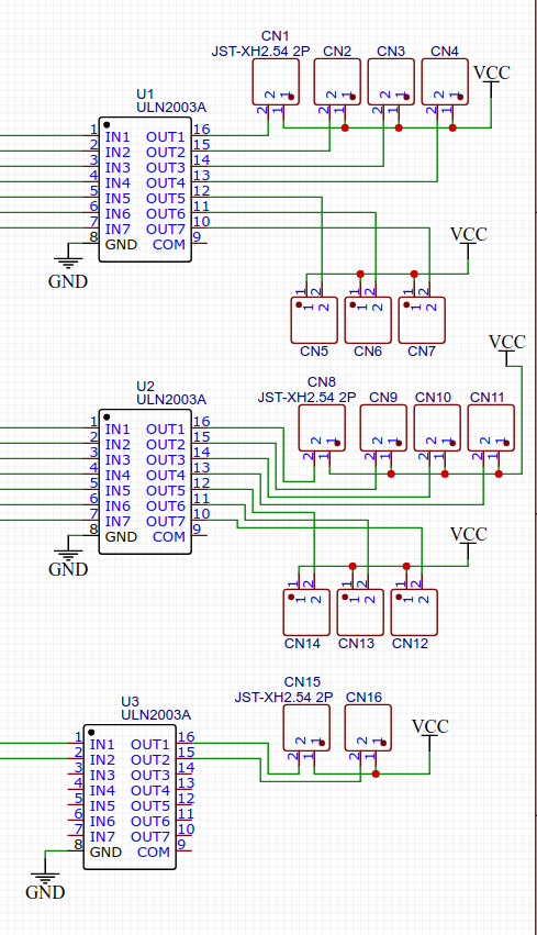

So we'll need multiple ULN2003 chips to cover all the outputs.
There are, uh, seven outputs. So that's 2.285714286 chips!
I mean three.
Now let's wire everything up.
Alright, looks good.
The connectors are a bit messy, but there's no surprises because we're basically just gluing modules together.

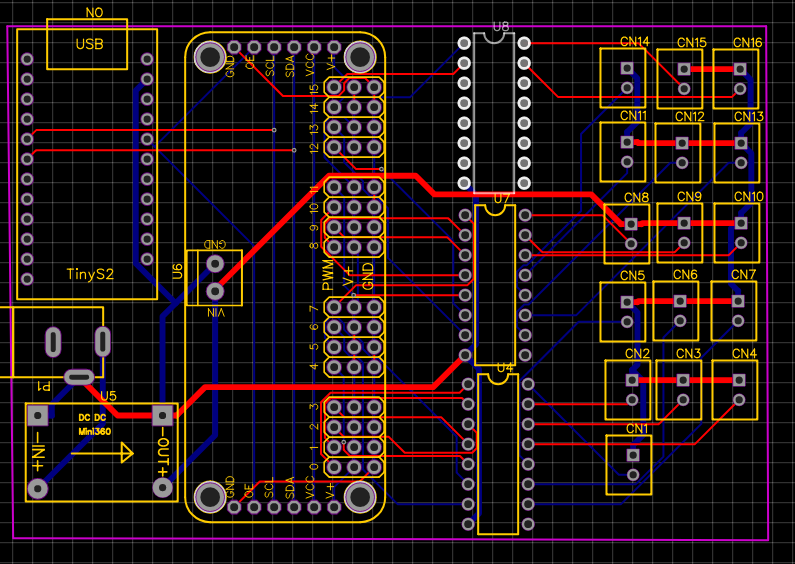

Now let's sort this mess out:
Autorouter, go!
That went better than expected. I forgot this was a dual-layer board. I probably could have even moved them closer together.
But I should probably increase the track thickness for the tracks carrying high currents.
Given the 1.7 Amps, I'd say 0.75mm should be fine.
Then I'll just wire that to the TinyS2... oh huh.
I've added a barrel jack to power the board instead, I'll just plug in a 12V supply.
Here's the updated version:
Much better!

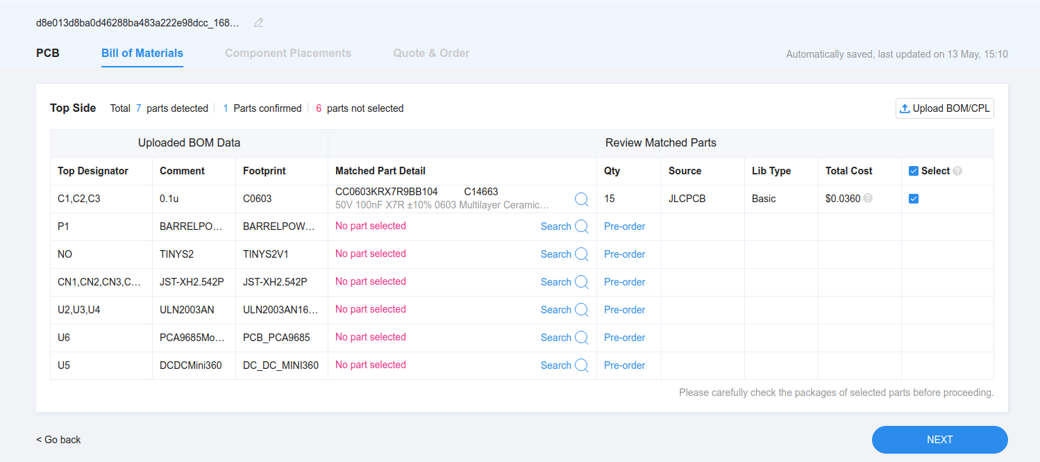

I'll go ahead and order a few of them. I've got plenty of parts here.
I did one last check of the workshop to make sure I've got everything. Due to my extensive hoard... uh preparedness I have everything needed. They can just use whatever generic they want for the SMD capacitor.
One last design check!

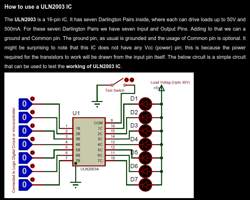

Hang on, is that actually how the ULN2003A works? I thought pin 9 was the flyback common.
Oh... I was using the module pinout, but I only have DIP chips.
What I want is something like this:
Shit.
The design is now fixed, but maybe not my sanity.
Hopefully, that'll be the end of it.

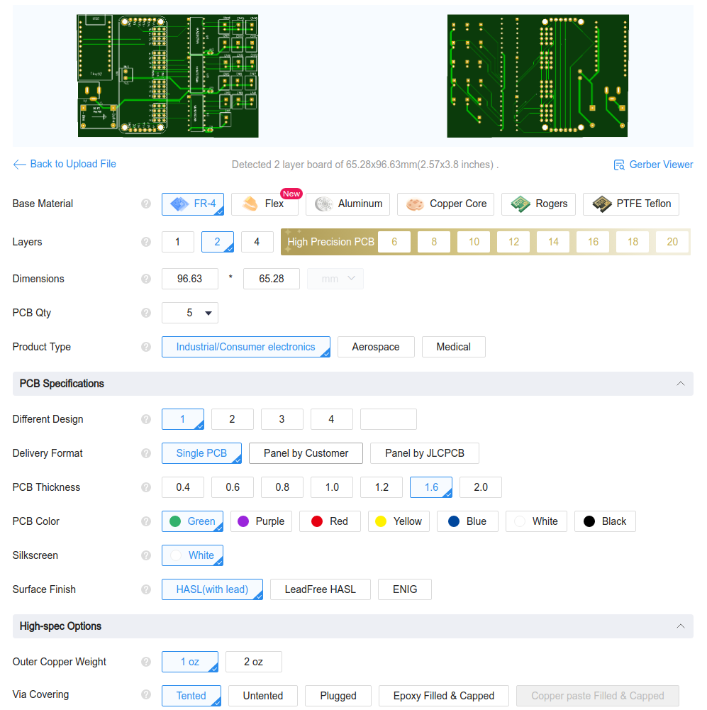

I went ahead and ordered the board to my workplace with the same settings as before.
Alright, well that might be a week and a half.
