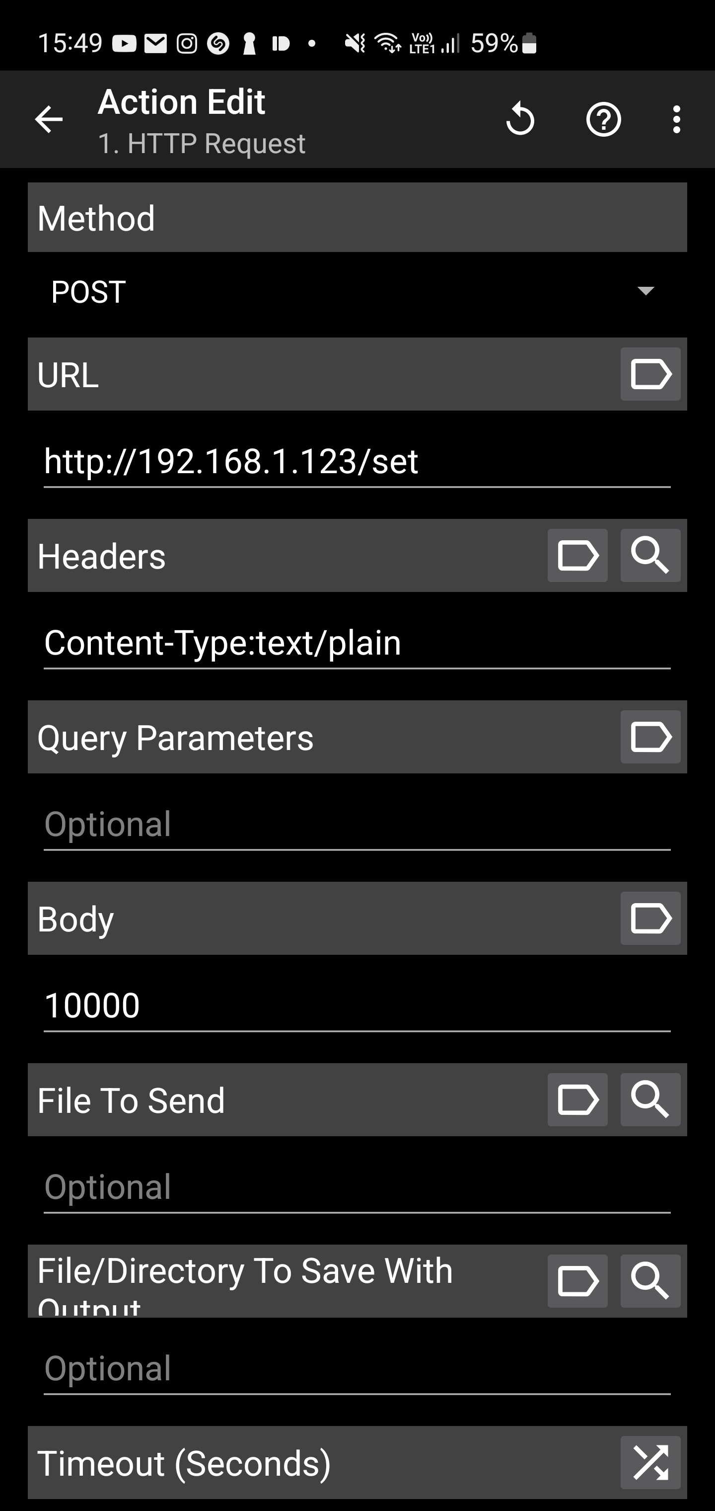

    In the meantime, I connected up the board and built a little webserver in CircuitPython:
    Yep, that's all of it. Easy stuff.
    All it does is wait for a POST to /set, convert it to an int, and send it to the PWM controller.
    Fortunately,  Adafruit has a PCA9685 library for CircuitPython; because I'm not one to reinvent the wheel.
    I made a little LED attachment to test it.
    When the headers finally arrived I assembled the rest of it and started testing.
    I tested it out with a POST action from the Tasker app on my Android device:
    Seems to work okay and respond to changes in brightness.
