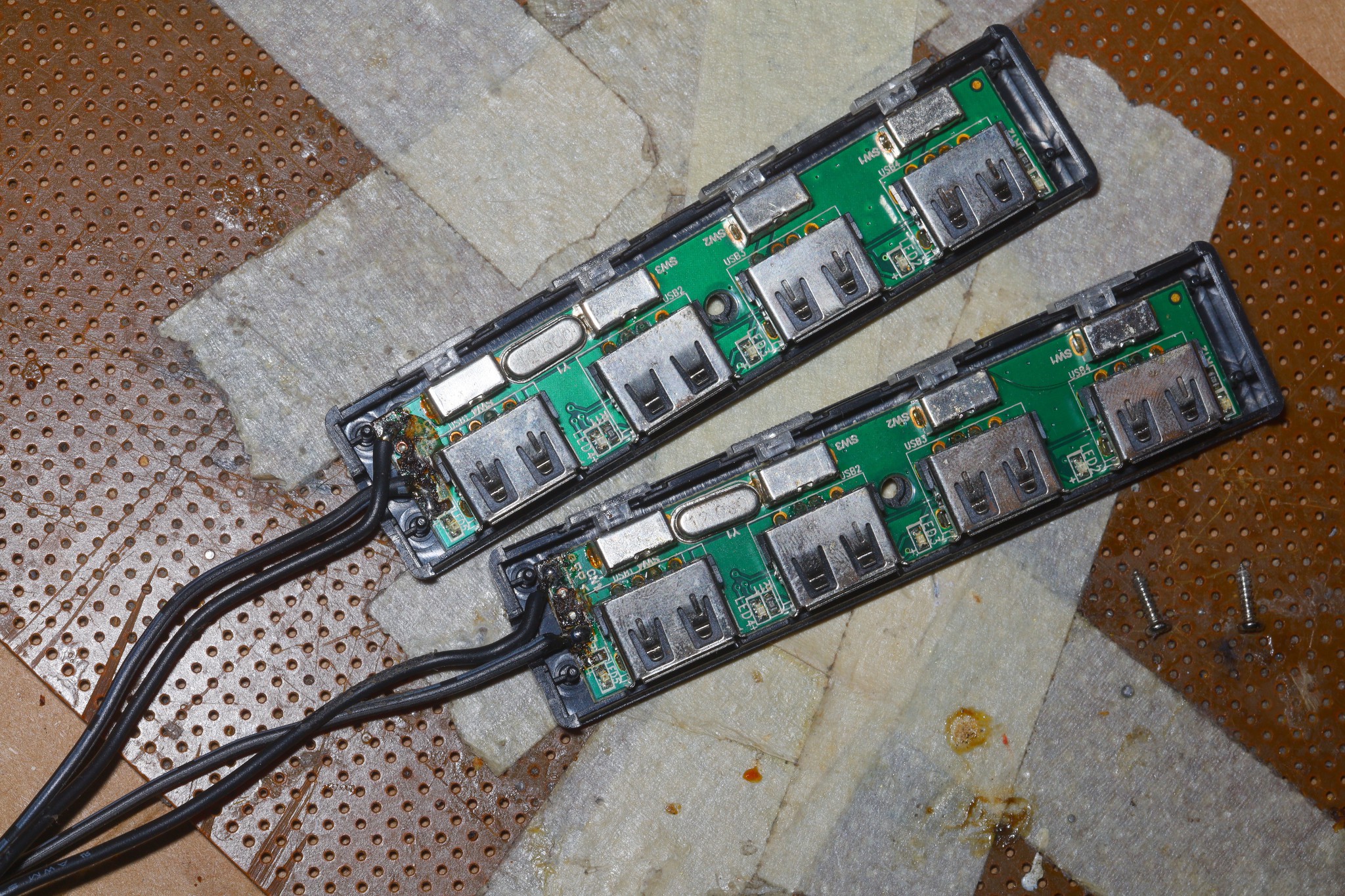

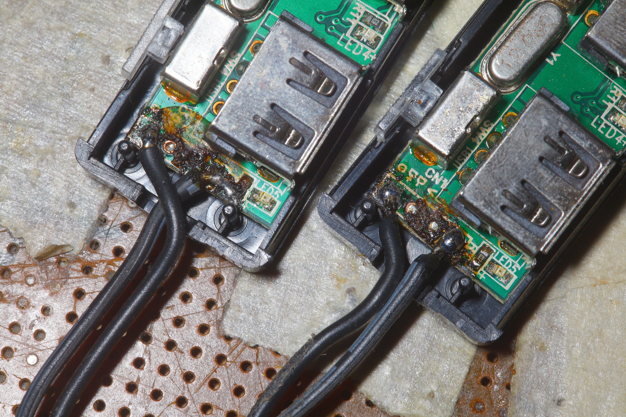

    After much experimentation, the problem with the pi 1b's converged on them being powered by a single USB expander & more importantly, plugged into the farthest ports.  They got more reliable when moving to the nearest ports on 2 separate expanders & pinging their ethernet to keep the network drivers alive.  Plugging in farther away in the expander made the pi's die more often.  Never thought of the traces inside the expander being a bottleneck.  The fact is the 1b's always needed beefier power connectors than USB or JST.  This setup was definitely living 1 day at a time.  The next step is going to be reducing the connections in the USB nest.

    After 3 years, this dual raspberry pi system began to die so frequently as to become almost unusable.  It seemed to be the piss poor network driver, but more likely they're just wearing out.  They have no frequency scaling but run at 700Mhz constantly.
    Rather than try any more fixes, it would ideally be replaced with newer 1920x1080 monitors driven by a single raspberry pi.  The problem is the final solution was always seen as a single 4k monitor.  Except for that, the next best solution would be dual 4:3 monitors, but 4:3 is super expensive.  Lions envision a time when 4:3 comes back to mass production because of vertical video.
    1920x1080 got a lot cheaper than 3 years ago but would still be a hefty tag & a lot heavier than the 1366x768's.  Head mounted displays with the required resolution would still be too expensive.  The monitors could be stripped down to the modules again.
    The dual raspberry pi was most reliable when they were all connected to another switch.  Things went downhill after they went on a new switch from a day job closet so there was a chance the new switch was the problem.  In hind sight, the smart move might have been not to touch the damn thing & leave 3 network cables on the floor as they were.  Changing ports & cables temporarily got it more reliable, but it eventually died.
    Finally added some insulators under the boards & chat gpt made a smarter script to keep the network alive.

    This once again made it temporarily more reliable, but it regressed the longer it stayed on.  Network & USB both seemed to be failing.  The way they started out functional & regressed over time pointed to some thermal degradation.  They were about as slow as bearable at 700Mhz.  Lowering the clockspeed wouldn't be an option.
