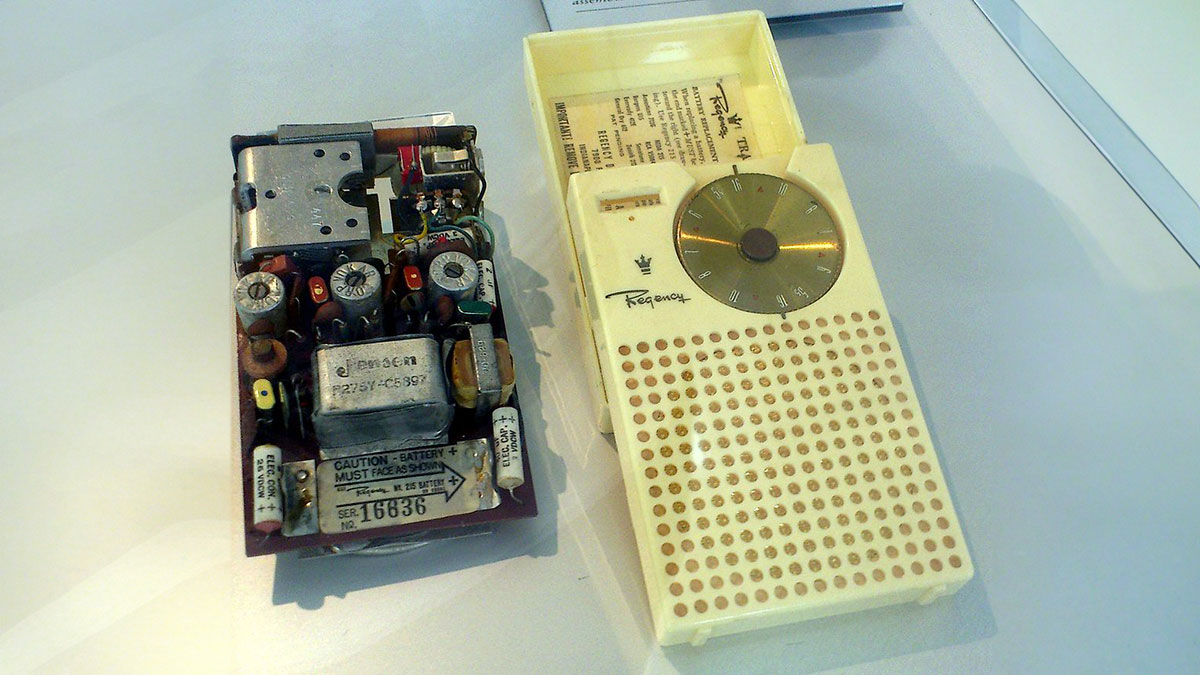

I almost built a 1954 Regency TR-1 superheterodyne transistor radio.
It was the very first commercially available radio receiver in the United States and globally, built entirely on transistors. How much have inner and outer designs changed in 69 (excellent) years?
The 1954 Regency TR-1 was not just portable but pocket-sized. And not just pocket-sized but autonomous and battery-efficient.

The Emerson 838 was called the world's first transistor radio in ads. However, it was a hybrid tube transistor and the all-transistor Regency TR-1 had already been released a year earlier.
It was a revolution, both technically and aesthetically. The Regency TR-1's case set the standard for radio design for decades, and no doubt even influenced the appearance of the Apple iPod.

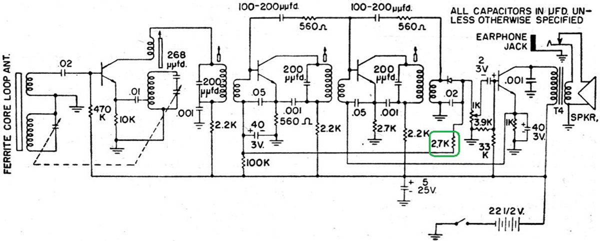

And this is what these structural blocks looked like in the real working circuit of the 1954 Regency TR-1. On the first transistor, counting from the left, a frequency converter is assembled, combining the functions of a local oscillator and a mixer.
The heterodyne here is an Armstrong generator, which is not surprising: the inventor of the superheterodyne radio receiver is Edwin Howard Armstrong.
After the heterodyne, two intermediate-frequency amplification stages with three resonant tanks are included, forming an IF filter. The two RC circuits at the top of the diagram are neutrodyne circuits that neutralize the Miller effect.
The transistors used in the Regency TR-1 were expensive and far from perfect. It was necessary to manually pick transistors with suitable parameters from a batch and manually select the capacitance of the neutrodyne capacitor within 100–200 pF (at the time, the correct term was uuF). We also had to use a 22.5-volt battery for power and use a low intermediate frequency of 262 kHz.
The voltage from the detector not only goes to the audio frequency amplifier but also regulates the transistor's bias in the amplifier's first IF stage. A weak signal is amplified more than an already strong one, which allows one to listen to distant and nearby stations without manually adjusting the gain. This is called automatic gain control, or AGC.

In addition to a push-pull, two-transformer audio amplifier, a BG4 transistor is used here as a detector instead of a diode. This is exactly what was done in the first laboratory prototype of the Regency TR-1.
With superior transistors having repeatable and stable characteristics, today's new radio receiver uses a reasonable intermediate frequency of 455 kHz. Neutrodyne circuits with hand-picked capacitors are no longer needed.
And to power the receiver, there's no need for 22.5, 9, or even 3 volts; 1.5 volts is enough—just one 1.5 volt battery!
The diagram shows breakpoints for measuring the operating currents of transistors in the absence of an input signal. In the last century, when setting up a receiver, base bias resistors were selected for each specific transistor so that the actual currents were within the list values.
Today, transistors and resistors are manufactured with much greater precision, so this setup step is completely optional.
The receiver kit even comes with pre-configured heterodyne and filter coils. So, it is fine to use the signal from a nearby powerful radio station or a micro-power radio transmitter to make fine adjustments for maximum volume and sound frequency.
