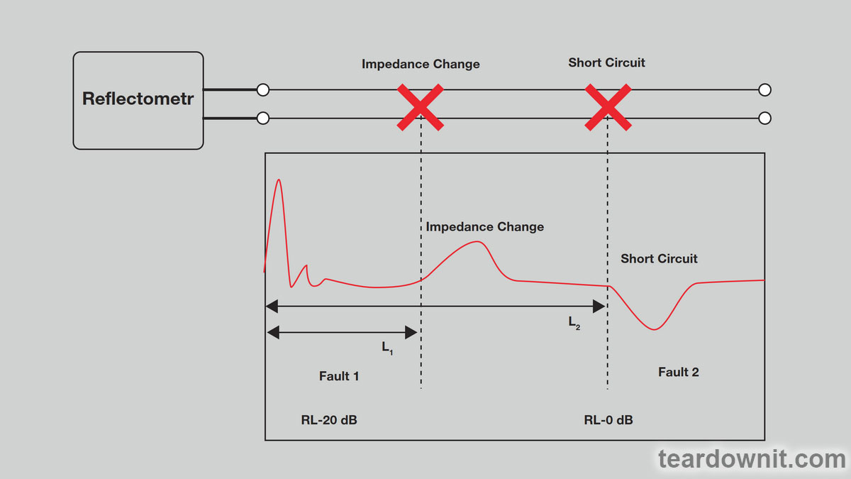

AUTOMATIC RETURN LOSS CALCULATION FUNCTION
Any damage to the cable leads to a change in impedance, and any change in impedance shows itself in the reflectogram. The amplitude of the reflected signal depends on the degree of impedance change and the distance to the spot of the change occurrence (both the pulse and the reflected signal are attenuated as they propagate along the cable). This fact significantly complicates fault localization. The pulse reflected from the defect will have a lower amplitude on the reflectogram (if the defect is located far from the reflectometer) than signals from other insignificant but closely located inhomogeneities (for example, cable splice points).
A special parameter has been introduced to assess the defect's size: return loss. With its help, one can compare the contributions of various irregularities and find the main one.
The mathematical formula for calculating return loss is as follows:
RL = 20 log10(Vo/Vr), where RL is return loss expressed in decibels (dBRL); Vo is the signal voltage at the reflectometer output; and Vr is the voltage of the reflected signal.
When the signal reaches a point of impedance change, some (or all) of its energy is reflected back to the device. By calculating the value of return loss for a given area using the above formula, one can estimate the amount of energy being reflected from this area and, therefore, compare the contribution of the inhomogeneities of the location.
To avoid confusion, it is worth remembering that small return loss values indicate that a significant part of the pulse energy is reflected at the point of the cable defect (i.e., return loss is small). The higher the return loss value, the weaker the defect, and vice versa. All the energy of the emitted pulse is reflected from the most significant defects, like a break or a shortage; the return loss, in this case, is zero.
Based on the change in return loss over time, it is possible to evaluate the change in the state of the cable line at the places where cable sections are spliced. If, for a section with a certain coupling, a value of 40 dBRL was obtained last year, and this year it is 33 dBRL, then the conclusion is obvious: the connection is degrading.
It is worth noting that the value of return loss measured in the area between the reflectometer and the defect is also affected by the distance from the device to the location of the fault in the cable since the cable itself introduces a specific attenuation. For example, if you are 100 feet away from a fault estimated to be 20 dBRL, the OTDR will show a value of 25 dBRL. If you are 500 feet away from the damage, the device will record 35 dBRL. For this reason, it is advised to be as close to the damage point as possible.
Return loss can be calculated from the reflectogram, but such techniques are difficult to master. That is why automatic return loss calculation dramatically simplifies the operator's life. Now, he can quickly use qualitative information (reflectogram) and quantitative information to localize a defect. Some reflectometers calculate return loss in the area between two cursors, which allows for an additional comparison of the magnitudes of any two abnormalities.
