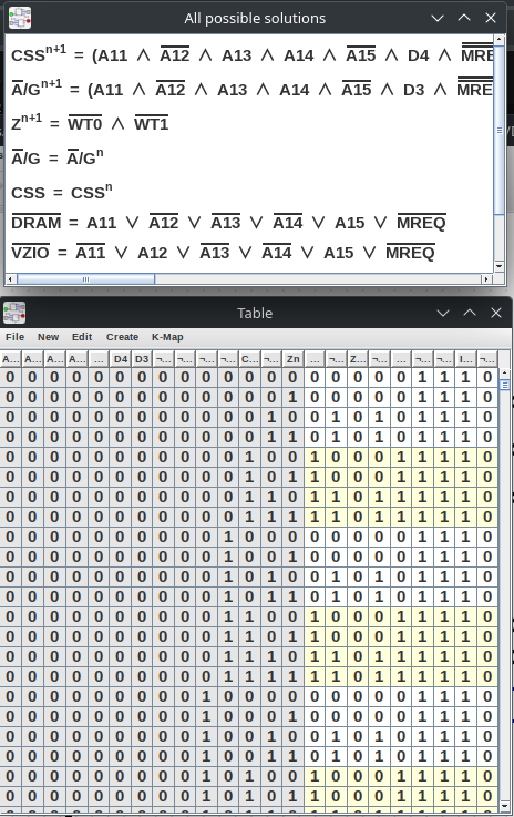

Well we start by breaking down the decode circuit to simply just the logic we need. For simplicity’s sake we build it again in H. Neemans Digital. Since “Digital” will simplify the logic to just the logic we need we don’t have to pay too close attention to the specific make up of the logic devices we are using as it will break it down into the simplest equation automatically, more on this later. We can go into the properties of each input and output and assign a pin to each, our device is a standard GAL part known as a 22v10. Its capabilities are specified in the data sheet but for simplicity sake we will say this device has enough logic units, and we’ve picked pins that will be compatible with the device.
We next build a register, for the two control lines we care about on just the graphics module. A register lets us clock the internal latch on every clock pulse, in our case we will clock it on the falling edge of the /WR line during any memory access cycle (pin 23 loops back into pin 1, the chip's Q input). Clocking the register every memory write cycle seems less than ideal, won’t we end up with a bunch of data we don’t need?

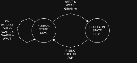

The solution, dual port RAM:
Dual-ported SRAM is basically traditional SRAM with one big twist: it has two independent ports and built-in collision detection. Collision detection allows the chip to generate a /WAIT signal on each port when a read or write operation starts on the other port, accessing the same memory cell (address) that the other port is accessing. When this occurs we get a /wait signal for the port that is late to the party. Each port has a wait signal and so we call them /WAIT-L and /WAIT-R. Consequently the data ports are also labeled left and right, but they are located in whatever orientation the designer desires when the board layout is done. This logic detection behavior is also first come first serve, so whichever port starts its read or write operation first wins access to the cell.
When two devices read from the same memory cell, there is no contention it simply splits the data path and shows that data on the bus on both sides of the chip. The device still generates a wait signal but it can be ignored if both ports are being read from. However, if you try to write on one side after you have already tried to read from a cell on the other side of the chip or vice versa you can get into a mess. In practice it is safer than our single port design. Truly if you try to write to an active data cell with the part we are using there is no contention, although the data is dropped and not latched, leaving whatever value was last stored there instead. This behavior is actually worse than the snow on the previous design, because the written data is lost in that case, and the display file can get corrupted resulting parts of the screen not updating correctly.
The solution is we need to check before a memory latch, if there is going to be contention from the VDG’s reads when the CPU needs to write. Furthermore, we need to shut down the chip select on the VDG side of the display memory, but only if there is read contention from the VDG. Lastly we need to hold it that way until the read operation is over. We don’t have to worry about reads because the VDG’s data port is wired in such a way it only reads from the display memory, and as previously discussed we don’t actually have to worry about situations where both devices read the same cell.
So then, what we need to do, is create a circuit that on every memory write, it captures the status of /WAIT (which we get by doing a logical AND operation on /WAIT-L and /WAIT-R). Furthermore, this must happen before we latch the data inside the memory. Also we have to only really do this when it makes sense, within a video memory write.

Z80’s
Write Cycle oversimplified:
Alright, let’s talk about the Z80 write cycle, because the timing here really matters. The write cycle starts in T1, and by the end of T1 the address bus is already valid. That’s the moment the rest of the system can trust the address lines and start reacting.
Then we roll into T2, and this is where /WR drops. That falling edge is the CPU’s way of saying ‘okay, this is officially a write now.’ From that point on, the data bus is settling into its final value, and the memory is getting ready to latch it.
The important part is the window between /WR going low in T2 and the actual data‑latch moment in T3. This is a small window where we can insert just enough logic to shut down a memory read on the VDG side, so that when the rising edge of /WR happens in T3 everything is good.
That’s the whole reason we care about the exact T‑state boundaries. The Z80 gives us a predictable sequence, but the hardware around it has to behave inside that little T2‑to‑T3 window if we want reliable writes.
This small window between when /WR goes low and /WR goes high, just so happens to be the perfect amount of time for our little state machine.
By grabbing the AND result of both wait signals on the falling edge of /WR and /MREQ, we can tell whether there’s a collision before the rising edge when the data actually gets latched; from there, the GAL can drive a pin that disables the VDG’s data port on the dual‑port RAM. In other words, we end up with a tiny state machine that watches each write, checks for contention, and, if there is any, temporarily takes the VDG off the bus so the write can complete cleanly. We basically add another state to the VDG that only kicks it off the bus in the event there is actually going to be a collision. The result is very tiny, basically imperceptible artifacts, that are constrained to a single frame. We don’t eliminate the artifacts, we just prevent them from being viewed by the user, as they can only last for three T states maximum.
It’s also important to understand that the latched /WAIT bit in the GAL does not directly store the /CS value; it stores the collision status (/WAIT) for the current write cycle. /CS for the VDG port is derived from that state, and it is cleared on the rising edge of /WR. In other words, as soon as /WR rises, /CS drops again, regardless of what the latched /WAIT value was. The collision state only ever lasts for a single write cycle.
Additionally,
because all of the behavior is edge clocked, there is no need to be
concerned with the specific timing of each part of the circuit; we
fixed our GAL timing problem, reduced footprint size and improved
memory contention artifacts so they aren’t visible to the user (yay us!)
Getting H. Neeman’s Digital to do the Hard Work:
Digital can do some fairly amazing things, but one of the coolest things is the circuit analyzer. It will break down a combinatorial and sequential logic systems into both boolean algebra, and a truth table. But it also can then take those two things, and through its synthesis menu you can have it build both the CUPL file and the JEDEC files for GAL production. In other words, you don’t have to bust out WinCUPL and actually write your .CPL file, digital simply does this for you.
There
are some limitations, for instance it won’t let you use a IO pin as
anything other than an input, and the stock version of the program
only lets you use the Q pin as a clock input (though I patched that
for my project). For our purposes this is perfect. We don’t need
so many outputs by modularizing the design, we can get around the Q
limit by simply patching the open source program so it works for us. You do have to understand the pin limits on your specific part and
tell Digital which inputs and outputs belong to what pin, but
it’s just a context menu operation.
For visual people like me this is a godsend.
