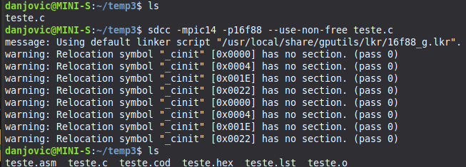

The final test is to compile a test program with following command line
sdcc -mpic14 -p16f88 --use-non-free teste.c

The compilation may generate some warnings but at the end the .hex is generated with success.
