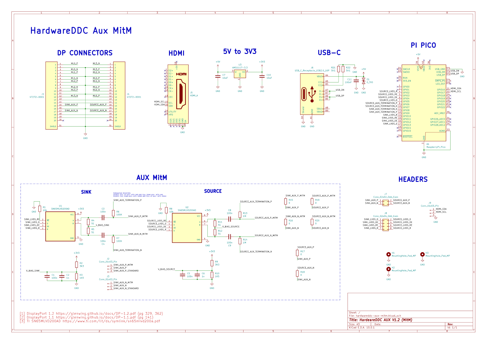

To MitM (Man in the Middle) the AUX channel, I'm using a pair of TI's SN65MLVD200A/AD transceivers. These can act as drivers and receivers—depending on their mode—to read and write messages on the half-duplex AUX channel. This decision was inspired by J5XS' DP-aux emulator. Although it focuses on modifying the EDID through a DP Alt Mode connection, the same basic principles apply to my application.
The MitM circuit relies on two halves—the sink and source transceiver circuits. The differential pair hardware layout comes from VESA's DisplayPort 1.2 Standard document. Admittedly, my current physics and math skills are lacking to fully understand this circuit from a theoretical level. I understand that termination resistors and their accompanying caps create some form of high-pass filter to allow the square waves to pass, while blocking the DC current.
I am also unsure why, in JX5S' reference design, the termination resistors are connected to GPIOs instead of directly pulled up to 3.3V and down to ground. While designing the board, I kept this design decision as if need be, cutting and re-routing the traces to 3.3v and the ground plane is easier than to the MCU pads. While prototyping in MicroPython, I simply defined the GPIO states as:

The side which plugs into the user's sink uses 100k terminations to act as a source, and vice versa. On the transceivers' outputs, they provide access to the differential pair as single-ended lines for the microcontroller to interact with. Like in J5XS' design, I left the 10k pull-downs to leave the transceivers in receiver mode by default.

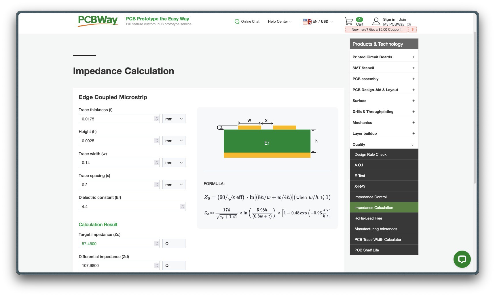

Using PCBWay's IPC 2141 high-frequency impedance calculator, I was able to control the differential impedance of the video lanes to 100 Ω ± 10% based on the selected stackup.
I opted to use PCBWay's 0.6mm 4-layer PCB stackup, as the thin 0.0925 mm dielectric prepreg material keeps the signal layer close to the ground plane. This was my first time working with and designing a very rigid circuit board. Although it was interesting to try it, and useful for my somewhat niche use-case, I might go back to a thicker PCB in the future. The main downsides of using a 0.6mm PCB were: excessive board warping when soldering the MCU dev board if not careful, greater potential of cracking copper traces and difficulty in unplugging and replugging the large DisplayPort Type-A connector. In the future, I will either use a 1.6mm 4-layer PCB with an odd stackup featuring a very thick inner core, or, depending on manufacturing constraints, a 6-layer PCB which would have the added benefit of sandwiching the DisplayPort video differential pairs with two ground planes.
