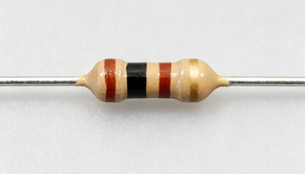

How to Identify a 100 Ohm Resistor?
Identifying a 100 ohm resistor depends on whether it is a through-hole resistor or a surface-mount resistor.
Through-Hole 100 Ohm Resistor Color Code
Traditional axial resistors use color bands to represent resistance values.
For a standard 4-band resistor:
Brown - Black - Brown - Gold
represents:
- Brown = 1
- Black = 0
- Brown multiplier = ×10
- Gold = ±5% tolerance
Therefore:
10 × 10 = 100Ω
A 5-band precision resistor may use a different color arrangement, such as:
Brown - Black - Black - Black - Brown
depending on the resistance coding system and tolerance requirement.
