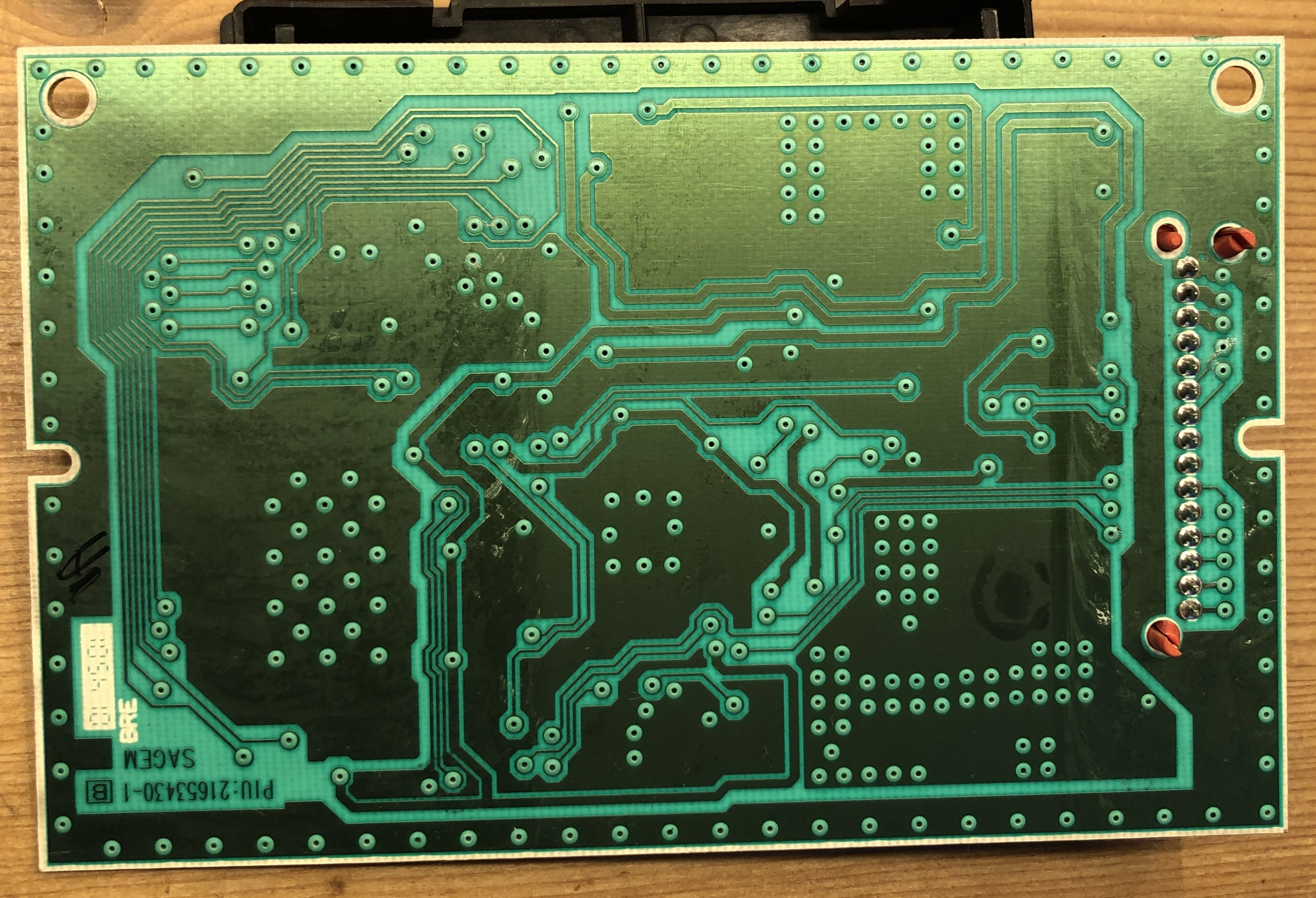

PHASE 2:
The boards shown here are a very early French Phase 2 version. CM62314 is the French Phase2 ROM. TMS5110A above the ROM is the speech synthesizer IC.

SYP x54 (Phase 1) Renault Number Sagem number Language 7700805300 21550991-7 (early REV.) French 7700805300 21552951-7 French 7700805301 English 7700805302 21552953-8 German 7700805303 Italian 7700805304 21552955-9 Spanish (1995) SYP_X54 ALLEMAND (German) SAGEM 21552953-8 / 7700805302 D
Synthesizer IC (DSP) : Texas Instruments [D36007NA] (probably a TMS320C1X)
ROM : NEC D23C4001E (DATASHEET)*
Microcontroller : Texas Instruments JL54 CF34086 (seems UNKNOWN to the Internet!!!)
*The Datasheet shows 3 lines that are "User definable" (active on high or low). On the board CE2 is tied to VSS. OE & CE1 are tied together. My guess is that OE & CE1 are active high... Maybe this info will help me later to read the chip...
Look what i have found... The ROM D23C4001E looks suspiciously like a M27C4001 Rom... Maybe its a simple read with my chip programmer... VPP on the 27C4001 is the 12V programming voltage input. As long as i do not try to write to my ROM it should be safe... The expected input on CE2 of the 23C4001 is +5v during normal operation (as we have seen above from the circuit). If OE and CE1 are configured to work like a normal 27C4001 it should just work to read it...
Ok. That was too easy. I just desoldered the ROM and put it into my EPROM reader. I used a preset for "NEC UPD27C4001 @ DIP32" and it read just fine... i guess. The Chip is nearly full of data and i have no idea how its encoded. I tried to import it in Audacity with every available setting. I got no results that sounded like a Voice...
Maybe you have an idea? Contact me.
PHASE 2:
(1999) SYP X54-2 SAGEM 21614185-9/3 / 7700847660
Synthesizer IC (DSP) : Texas Instruments TMS320C14 [D34004FN] (DATASHEET)
ROM : OKI M531602C (DATASHEET)
Its nice that they actually printed the type of DSP on the chip. That gives me a nice clue to what Phase1 is using... The ROM is exactly the same as they used in "TYPE3 (Laguna) Phase 2" (maybe even same content).

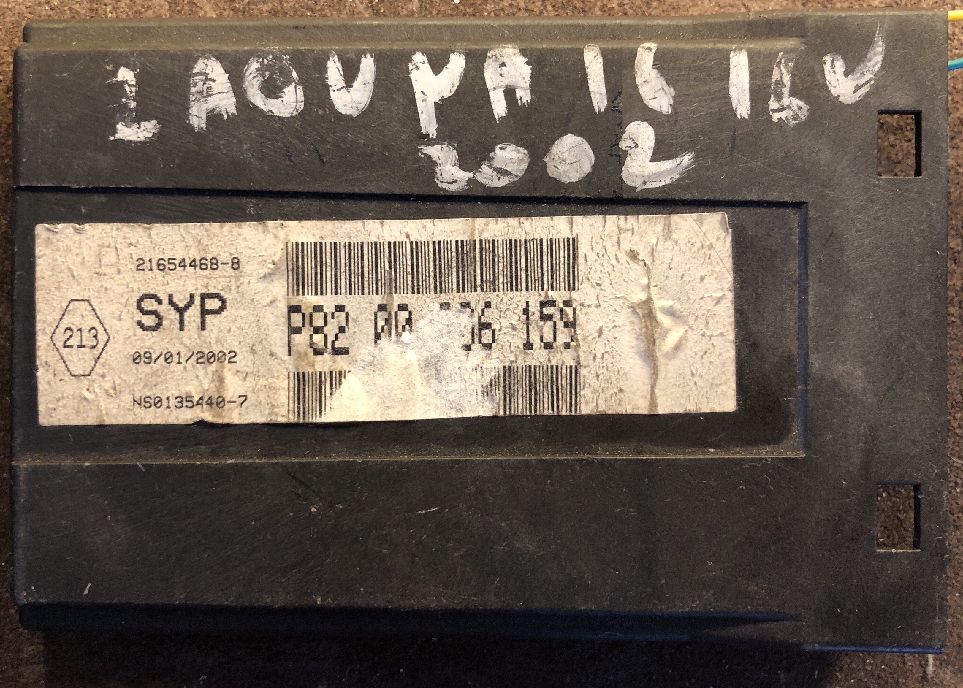

Renault Speech Synthesizer "TYPE 4" 2001 - 2005
07/12/2023 at 02:33 • 0 comments< TO "TYPE 3" | <HOME> | TO "TYPE 1">
"Type 4" is used in Laguna 2 / VEL SATIS from 2001 till 2005 (after facelift in 2005 speech was not available anymore)
- It is a sample based system.
- Seperate Box (Uses CAN BUS communication) [contains all languages]
- Languages: French, English, Italian, German, Spanish, Dutch, Portuguese, Turkish, (Japanese, Russian)

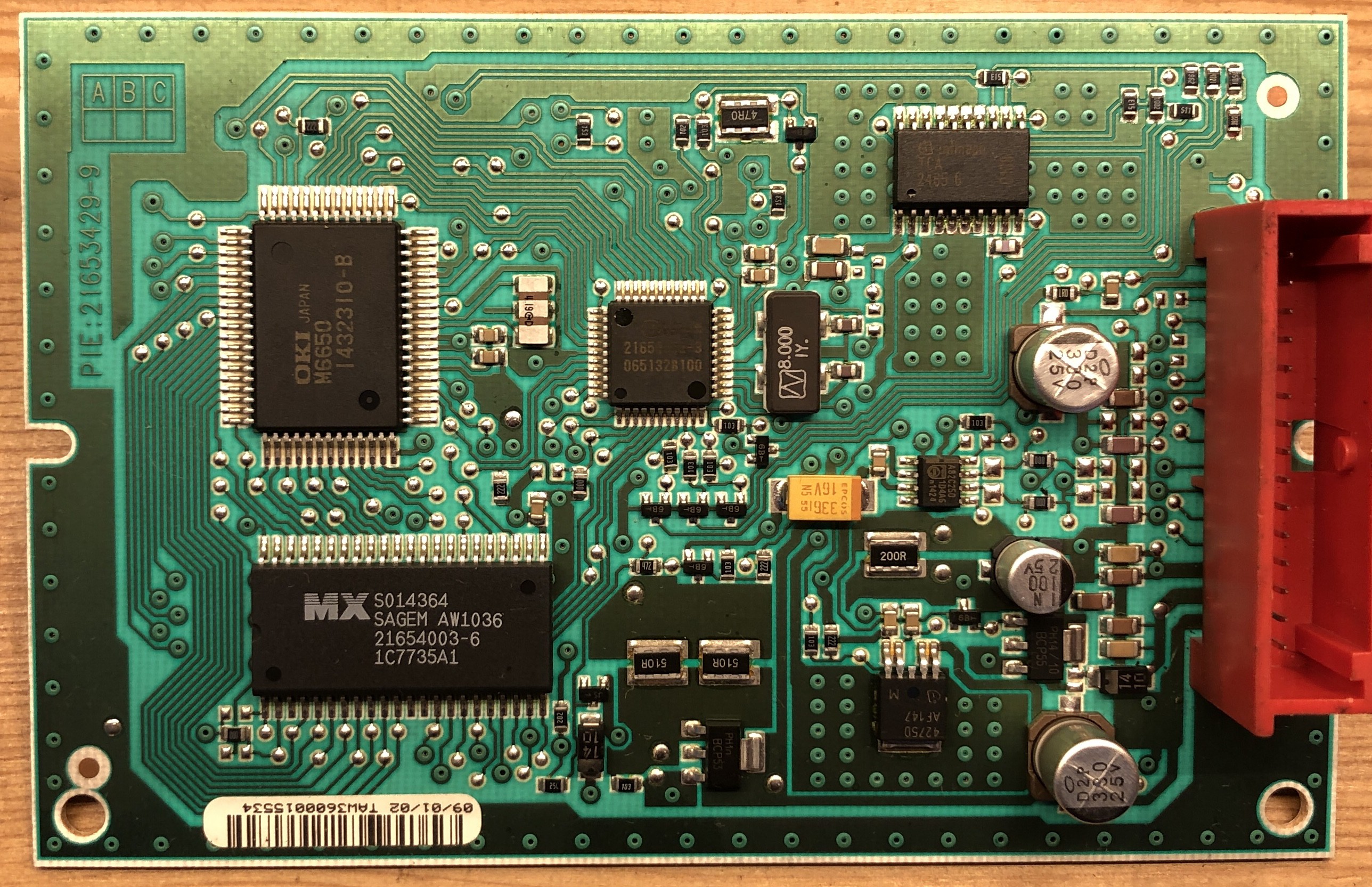

P8200006159 / 21654468-8 | January 2002
Voice Synthesizer IC : OKI M6650 (Datasheet)
ROM : UNKNOWN 44Pin Macronix (MX) ... [branded as SAGEM AW1036]
A lot of useful informations HERE
For this system to work you need the "high" version of the cluster (the one with the LCD display). This version of the cluster has the second CAN BUS connector to connect the speech box to. The speech is triggered by several control units over CAN-BUS not just the informations from the cluster like in LAGUNA 1.

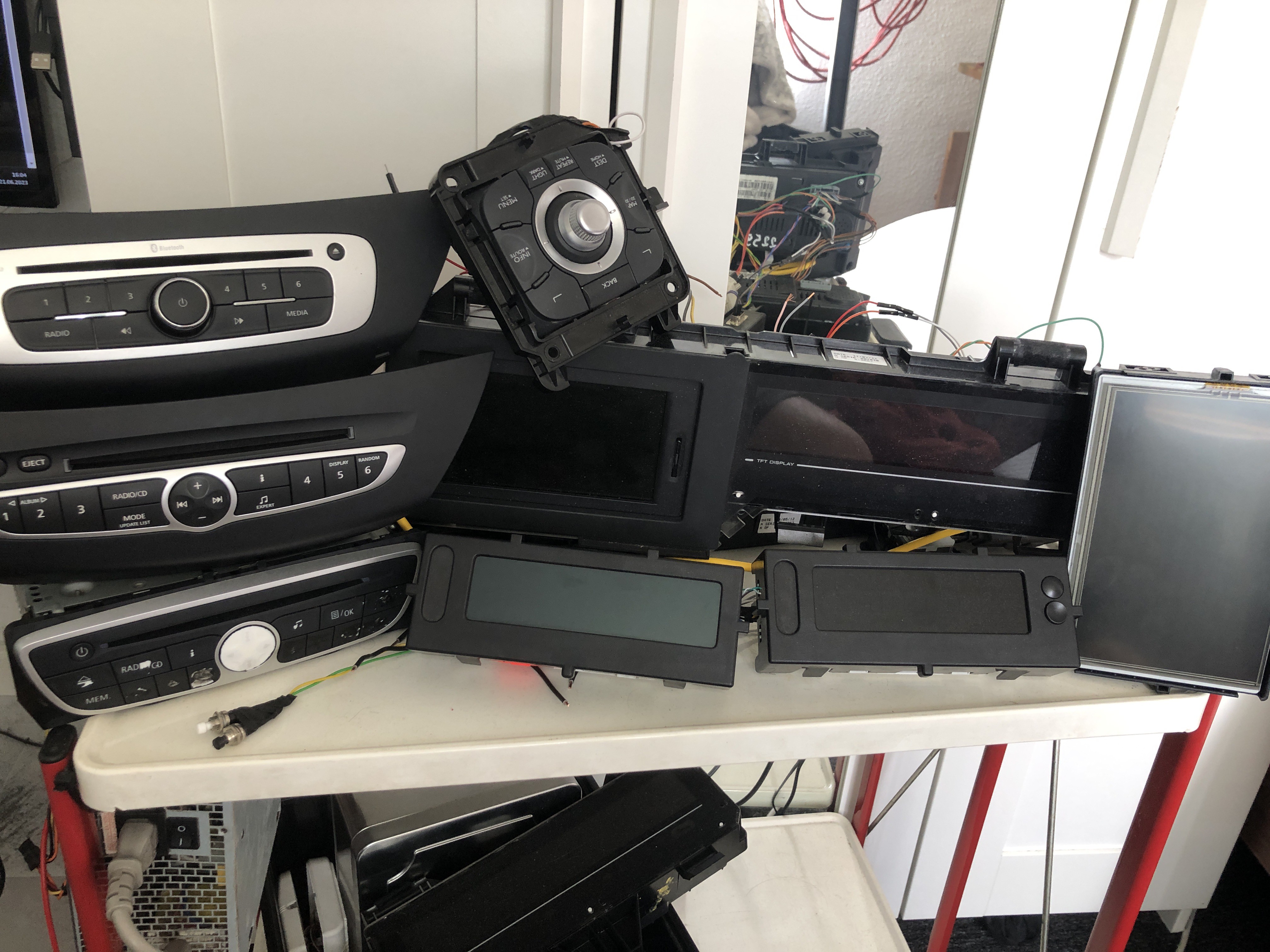

06/21/2023 at 14:36 • 0 commentsMy goal is to create a useful guide for all Infotainment systems Renault has used over the years that use some kind of data communication between components.
Components that i own will be reverse engineered and documented. If you have any new informations that need to be added please feel free to leave a comment and i will see how we can do that.
To be fair all this is pretty complicated and i will do my best to give it some kind of structure... Links will bring you to more information i have written.
This Page will evolve over time. Its not the final form yet!
Lets get a small overview of general systems they used:
- Radio + Display
- Radio with integrated Navigation system + Display (earlyer models)
- Radio + Display with integrated Navigation system (later models)
At this point in time i know that external Amplifiers, CD Changers and maybe external Navigation computers that use data communication exist in Renaults universe but my main priority is the communication to the Displays and the protocols they used. I can not gurantee to cover each and every component they ever used.... but i will try ;)
Small rant on complexity:
Lets first talk a little bit about the weirdness that comes with making tech for cars. A specific car model normally is made for a long period of time. Even if the chassis of a car is sellable in 10 years the tech inside often is not. So traditional car manufacturers invented Facelifts / Phases . This is a point in time where new Tech or Parts are introduced into an existing model together with some fresh looking new outside parts. Now there is a weird combination... A new Model of car is introduced with new tech, and all other cars will get the tech but without a Facelift on the outside. Ok, thats a Facelift too... but just a technical Facelift. This will result in car models that have several different generations of Central electronics, Engines, Infotainment, and exterieur Parts all mixed in the wildest combinations over the years. At Renault there was a point in time where the oldish base cars could not natively talk to all the new tech they have thrown at them so they needed a "translator". A so called Multimedia Interface Unit wich was a can bus transceiver that rewrote all the can messages to make all of that compatible.
Sometimes i have the feeling that some decisions in the car tech sector are made to keep jobs relevant. Not that this is a bad thing to keep Jobs, but it adds to the uneccesary complexity to the systems used in cars that we all pay for (if we drive cars). Of course it is better to have more seperate parts in case something breaks. BUT just take the money you saved on the complexity and put it towards better quality in the one part... Ok enough of my foolish rant.
What i wanted to say was :
Sometimes you can find several versions of Radios and Displays in one car model that are not compatible to each other.
My idea was to take each car and list the Radios / Displays they used for it. But after i found out nealry all cars went through several different general systems that used different Radios / Displays and sometimes different remote controls i decided to not sort by car but instead sort by system. I had to come up with names for the systems. If i can find names used by Renault in its documentation or on the Parts i will use those.

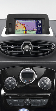

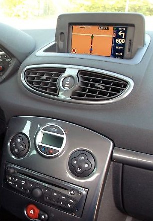

Radio + Display (with integrated Navigation System)
2008 - 2016
This Generation consists of 2 different Radios, R1 and R2. R1 is a basic CD Player and AM/FM Radio. R2 is a little bit better equipped with Bluetooth
Display A2 and A3 are also the MIU! If Display A2 or Display A3 are replaced by TomTom a MIU is mounted (except for Scenic 3 where the Cluster is the MIU).
Radio R1 + Display A2 (Protocol R1):
Radio R1 + TomTom (Protocol R1):
Radio R2 + Display A3 (Protocol R2):
Radio R2 + TomTom (Protocol R2):

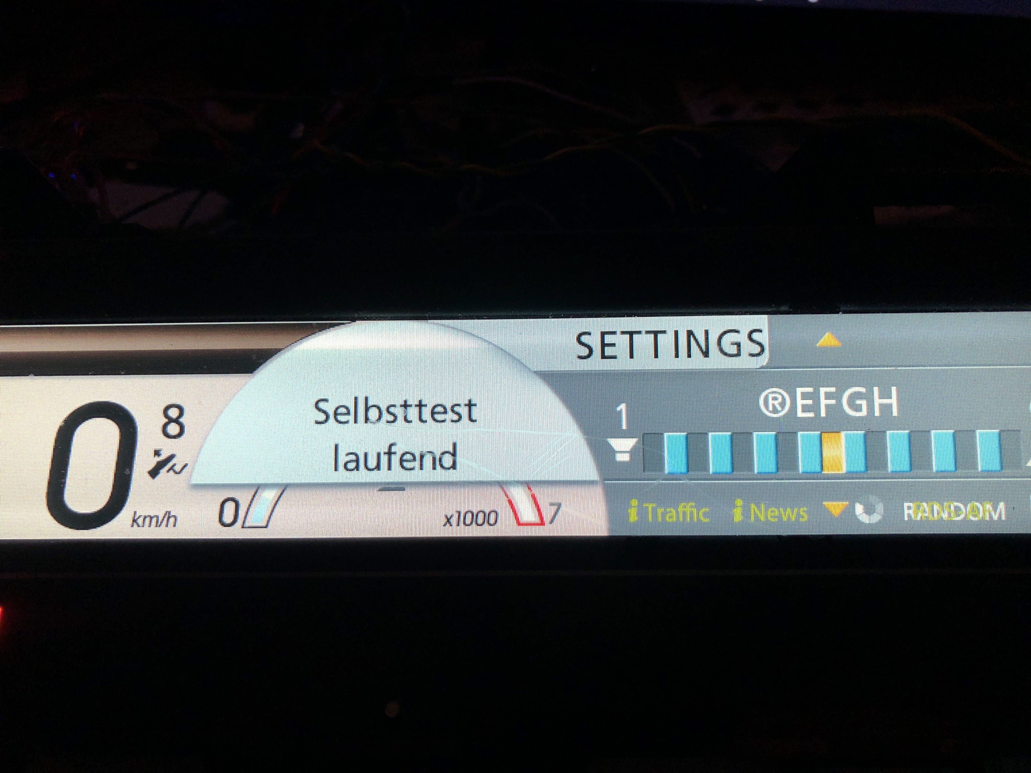

06/10/2023 at 22:41 • 0 commentsAfter we understood the protocol it is time to have a look at the content of a display message.
You should be familiar with Hexadecimal to properly follow this Blog.
To not make it more confusing as it is i will skip telling you about "endianness" and just say:
We use the way the Arduino IDE counts the Bits and Bytes.
- Bytes in a message are counted from 0 to 7 from "left to right".
- Bits are counted from 0 to 7 from "right to left".
ATTENTION:
There are slight differences wich parts of the Message are used depending on our output device. The small LCD Display , the Scenic cluster and the TomTom Navigation generally will display the same but use more or less Bits and Bytes to do so. I will try to make the differences as clear as possible.

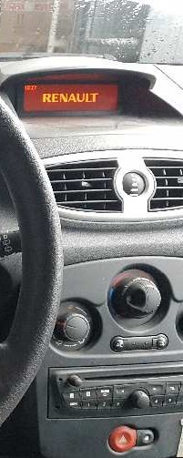

The LCD Display uses 4 Bars, 6 Arrows, 4 Speakers and Text to create some kind of a menu structure. All of these symbols and bars can be set individually. The LCD Display can show any symbols or bars at any time. We just have to set the specific bit for a symbol or bar and it will show up. This will give you a wide range of flexability on how to show menus. Thin and thick bars above and Below the Text will indicate "boxes" and "highlights" OR they will be used as bars (fader, balance, Bass Treble ...)
Scenic cluster and TomTom Navigation do not have the limitation of a segmented LCD display and can show a nicer menu structure wich is more specific to the content. Scenic cluster and TomTom use Byte1 in Consecutive frame 9 as a "message Type". Byte1 can be 0x00 (0) - 0x1D (29). Here we have 30 different pages to show all possible menus the radio is abled to generate. Another difference is that the "bars" "speakers" and "arrows" used for the LCD display are not shown here. But some parts of these elements are used to control the elements on the pages. Also not all Symbols will show up on all pages. The last bigger difference is the "modifier". On the LCD display the "modifier" will just show "cd" or "cd changer" symbol. On Scenic cluster and TomTom the "modifier" works different. In addition to "cd" and "cd changer" we also have a "fm" and "aux" modifier. This modifier will change some of the pages. On a couple of pages we get different Texts.
Scenic cluster an TomTom have a "big" and "small" display mode. We can define if the message will show up as a full page or just as a status bar. This is not used on the LCD Display.
The last slight difference is between Scenic cluster and TomTom Navigation... Scenic cluster is a little bit tighter in its restrictions. TomTom will show more of the Text on nearly all of the pages. Also Scenic cluster has many fixed names displayed on each page .
But i will point out all differences and provide examples for every case in the upcoming Project.

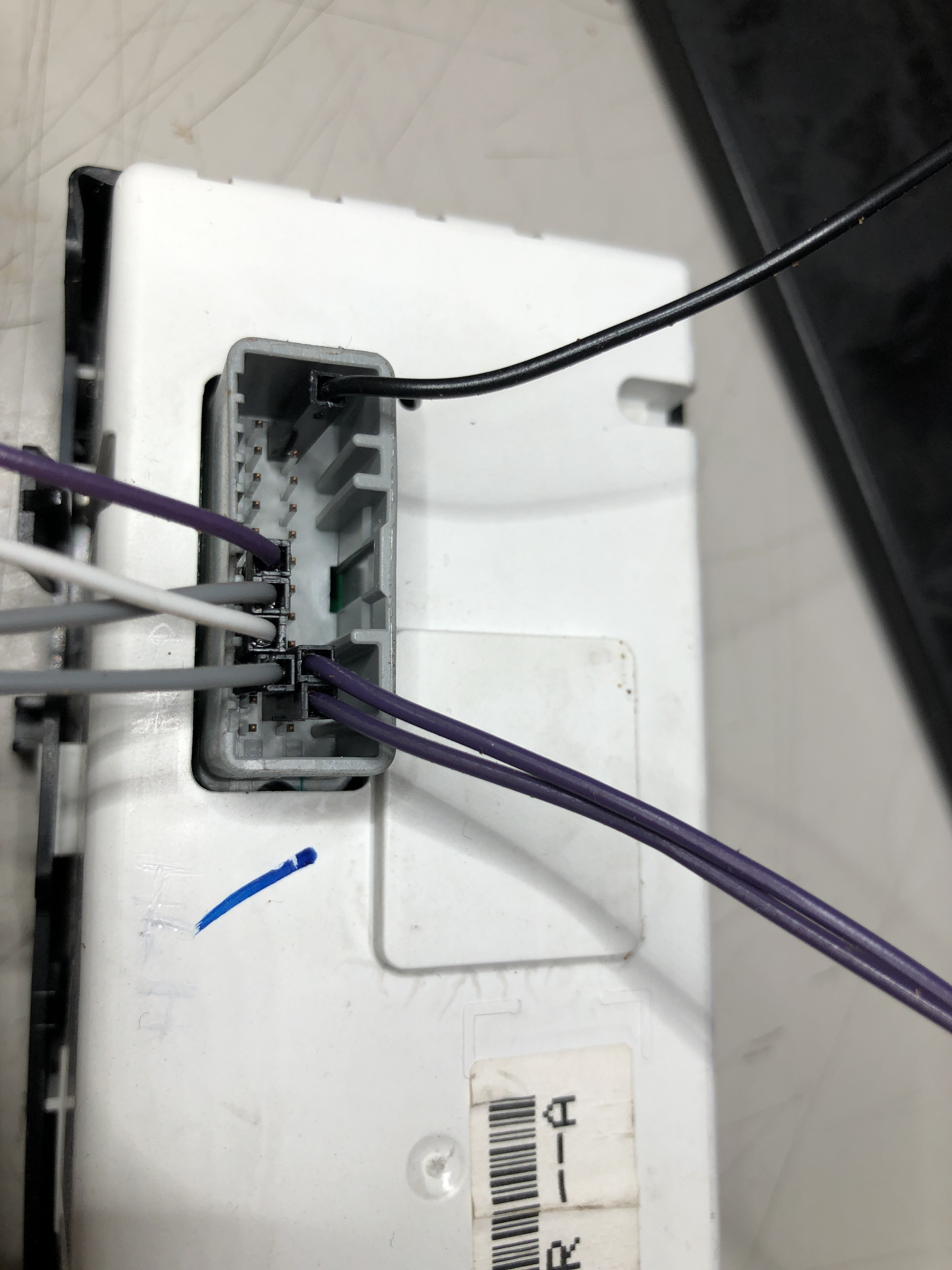

06/10/2023 at 04:08 • 0 commentsAfter we have a working Test Setup and properly working tools its time to start digging into bits and bytes.
I started looking at just the Multimedia can bus of the Scenic 3 Cluster without any other connected devices.
There is a LOT going on. even without any connected devices. This is why its important your tools are FAST.
This is our baseline. We really know everything we see here is not from the Radio.

For an upcoming Project i wanted to understand how a Radio in a Renault Megane Scenic 3 "talks" to the Display to show informations. (Megane 3 : 2008 - 2016)
I started by looking for wiring diagrams to see how everything would connect in a real car.
Of course i went to my local Renault dealer to look up the diagrams and i have not downloaded them from the internet. This is why i dont know that wiring diagrams from Renault are called "Visu" and have a numbering system starting with "NTxxxx" followed by 4 numbers (x) wich represent the type of car.
Let me sum up the things i have learned from the wiring diagrams first and the pick up on the important points:
- Megane (Fluence) and Scenic are basically the same cars underneath.
In the Megane/Flence you have a Cluster and a seperate "Info Display". The "info display" can also be a Monitor if you have the TomTom Navigation option.
In the Scenic the Cluster is the "info display" at the same time. in addition to the Cluster you could order the TomTom Navigation monitor.
The components of the Multimedia system use Can-Bus to communicate. It is a 500kbit/s Can Bus system.
- Megane and Scenic share the same types of Radios.
That was a useful information... BECAUSE : i looked up the radios that could be fitted into Megane Scenic. And i found out that the same Radios (with slightly different faceplates) are also in A LOT of other Renaults from this time ... Like Twingo, Master, Wind, Clio and of course Megane Fluence and Scenic and all models i forgot to mention.
In short: If your display looks like this (or similar)it will most likely work. Note the bars above and below the row of text!
As i said on Scenic the Display is integrated into the Cluster and looks like this:
The third Option to use the Display data is to show it on the TomTom Navigation System wich looks like this:
I was amazed how much this protocol was used by Renault and decided that it might be really useful for a lot of people to know how to use this in projects.
As soon as you take out the original Renault Radio and replace it with something different the display is is unused. Or wouldnt it be really awesome to display some kind of information like a voltage or temperature? Or even a own menu structure to set things or make stuff happen? So much potential...
SO i started to order some Hardware to reverse engineer all of this. And the fun begun.
The tools i use i will discuss in the next episode of this blog. We will focus here on the Car Hardware.
Because i i didnt know all the details i described above i started to order random Renault Radios from around the time renault made the megane 3.
And i also ordered a scenic 3 cluster from 2013... because it was the cheapest one i could find for around 20 Euros. Wich looks like this:
The price range for scenic 3 clusters is amazing... from basically nothing to "are you kidding me" ... Some sellers think that a TFT Display from a 14 year old car that sold A LOT of units is still worth 200+ Euros... But... lets just continue with the story.
