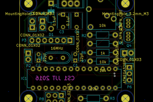

Finally i got the powe/ mode button, the shooter button and the settings button in a row on the female connector. I'm also using the Gopro AV cable to get video, GND, and add an external power supply.
This is my circuit to control the camera, I've tested with an Intel Galileo board 5V gpios.
