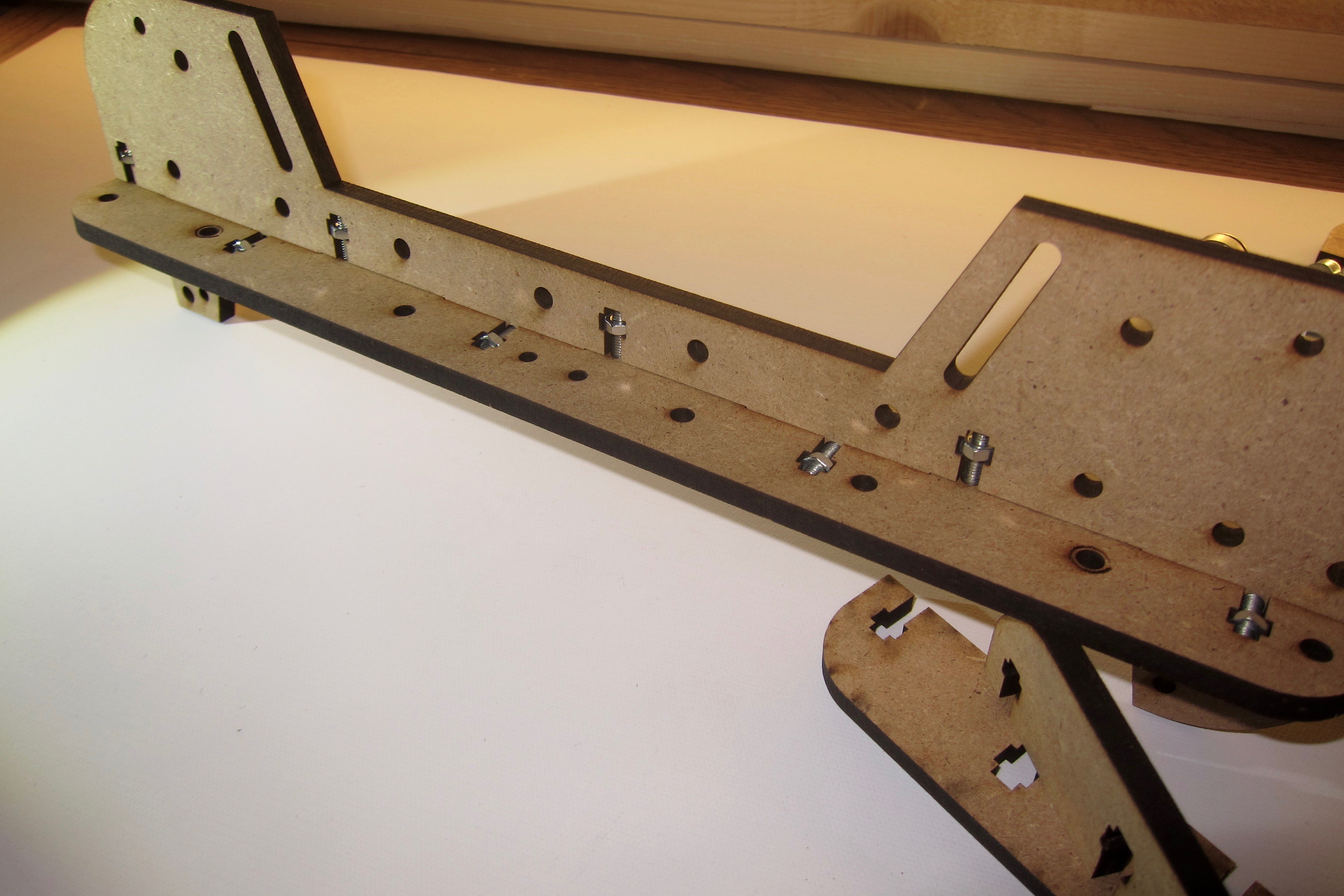

    Step 1
    Lay out the laser-cut frame as in the picture.
    Align the pieces so that the scorched line is covered as in the picture.
    Assemble the other half. The assembly should look like this.

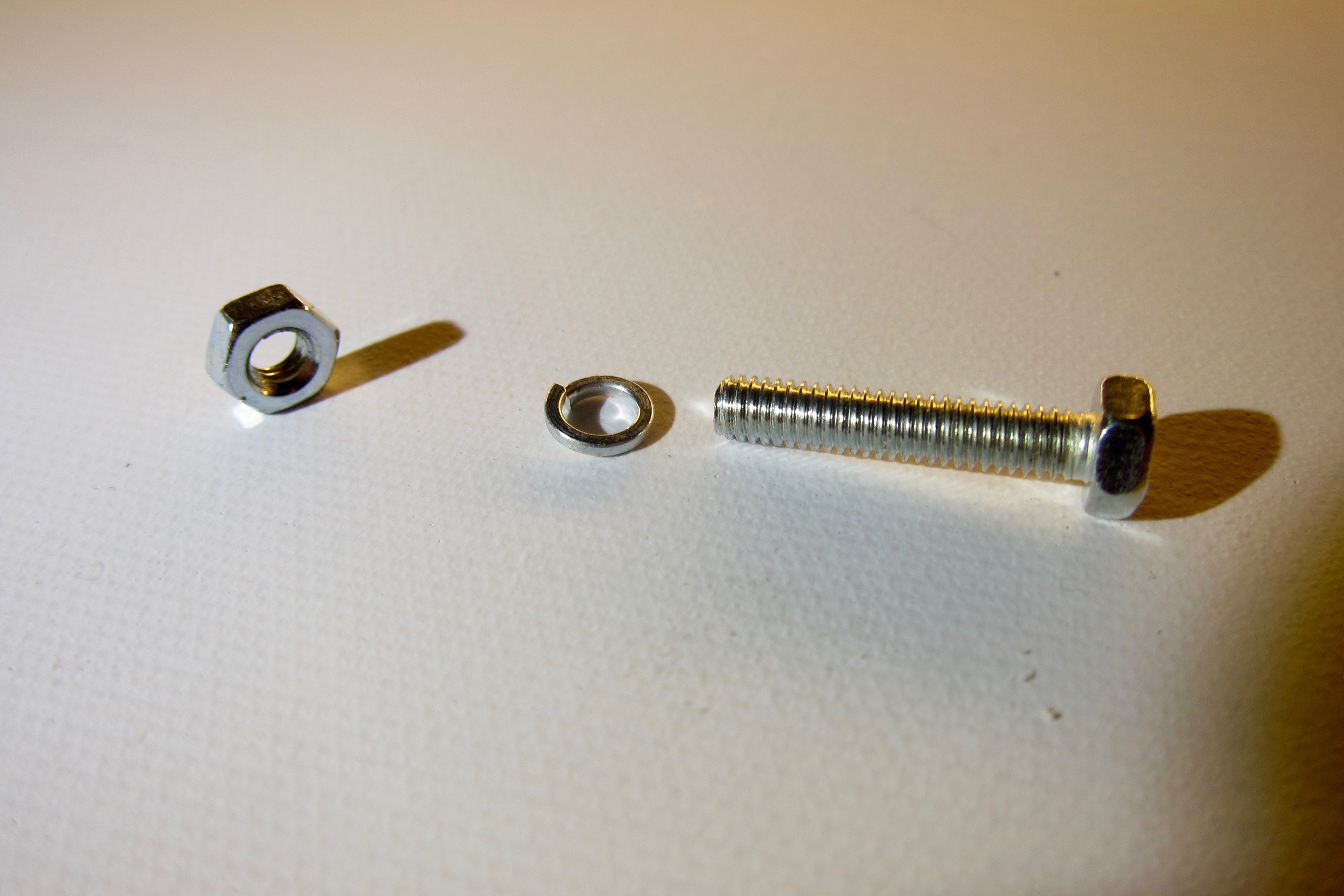

    Step 2
    Use 8 M4x20 bolts and nuts with a locking washer to connect each side of the frame.
    For the motor mount make two assemblies as displayed, from two M5x40 bolts, three diameter 10mm M5 washers and 2 diameter 20mm washers and a 525 bearing.
    Then connect the stepper mount with these two as in the picture. Use an M4x15 nut and bolt for the central connection.
    The other side should look like this, notice that the scorched holes are on top.
