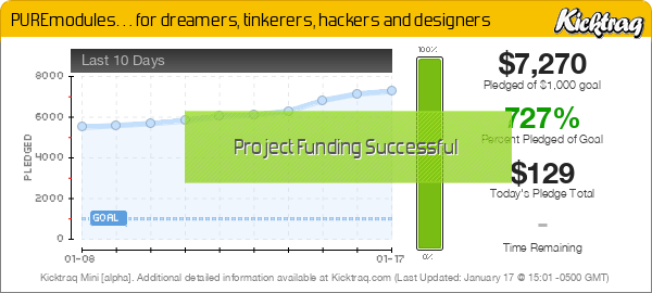

  • PUREmodules Kickstarter on kicktraq
    Pure Engineering11/30/2016 at 17:24 0 comments
    Making progress to the goal. Thanks for everyone backing so far and everyone sharing the project.
    PUREmodules… for dreamers, tinkerers, hackers and designers -- Kicktraq Mini
