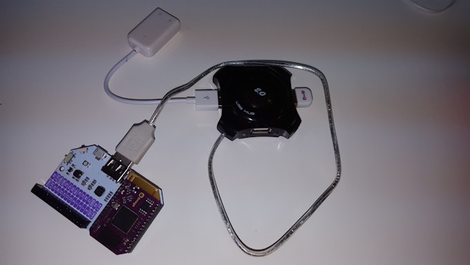

1Step 1
Hardware and Omega Setup
Since the Omega only has one USB port, we need a USB Hub to connect the BLE Dongle and USB soundcard. The sound card is where you will provide the auxillary output to the speakers.After you are done this, make sure you are running the latest version of the Omega's firmware:

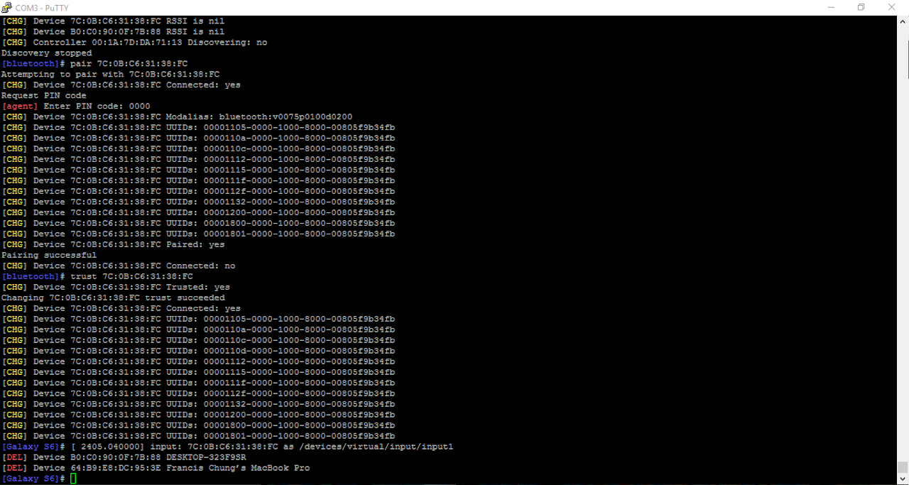

Now to actually connect to a device we have to use bluetoothctl.
Enter the command:
bluetoothctl
You will enter into the bluetoothctl menu and your dongle will be listed as a controller. Run the following commands to make the dongle discoverable/pairable and allow it to discover other devices.
agent on discoverable on pairable on scan on
Once you target device is located your can pair with it using the command:
pair XX:XX:XX:XX:XX:XX
At this point you will be prompted to enter a PIN on the command line which you will then have to re-enter on you remote device for verification. We need to trust the remote device so that the remote device can initiate the connection. To do this, enter the command:
trust XX:XX:XX:XX:XX:XX

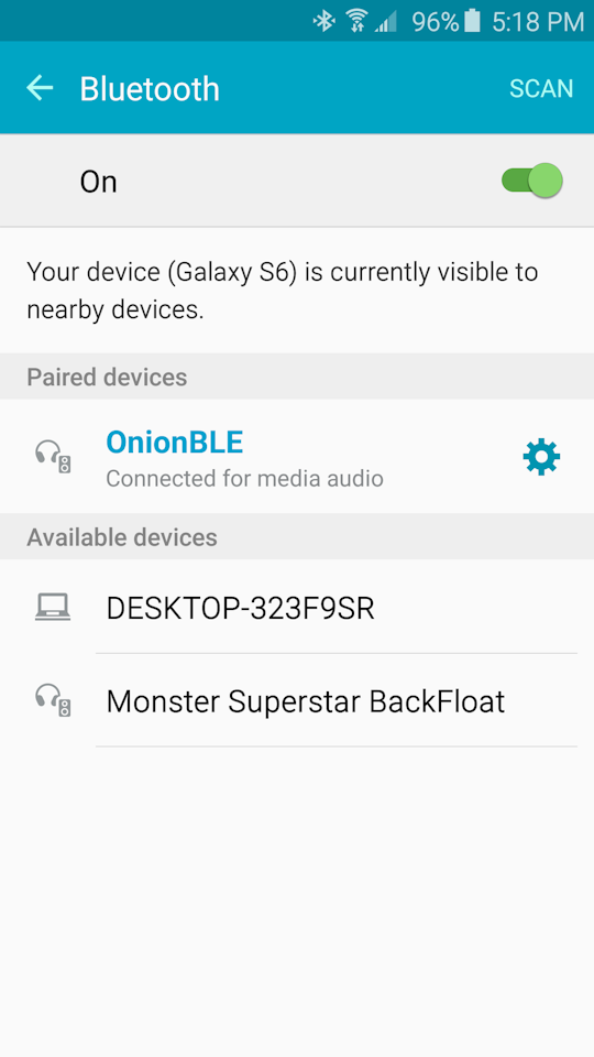

5Step 5
Initiating Connection from Remote Device
Try initiating the connection from your device and it should work. You should see a screen like so. The remote device should be registered as an input device.
You can now quit the bluetooth menu with the command:
quit
Also, your phone should recognize the OnionBLE as a media audio device.

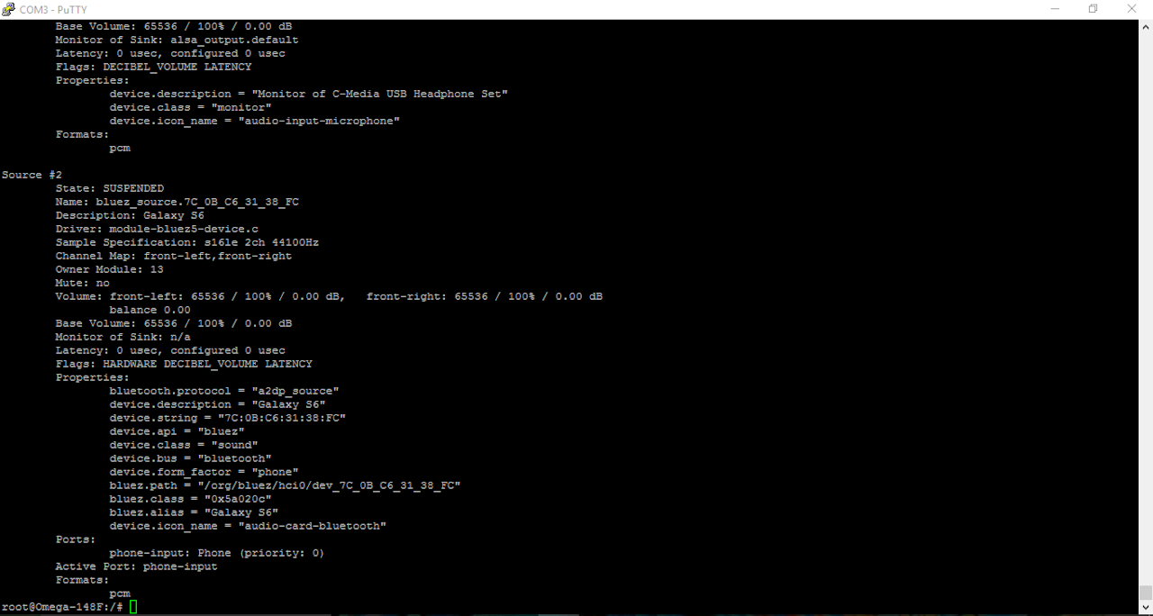

To get the audio to play, we will be using the
pactl
utility.To see our audio sources run the command:
pactl list sources
Your device should show up as a source. For me it is source # 2.

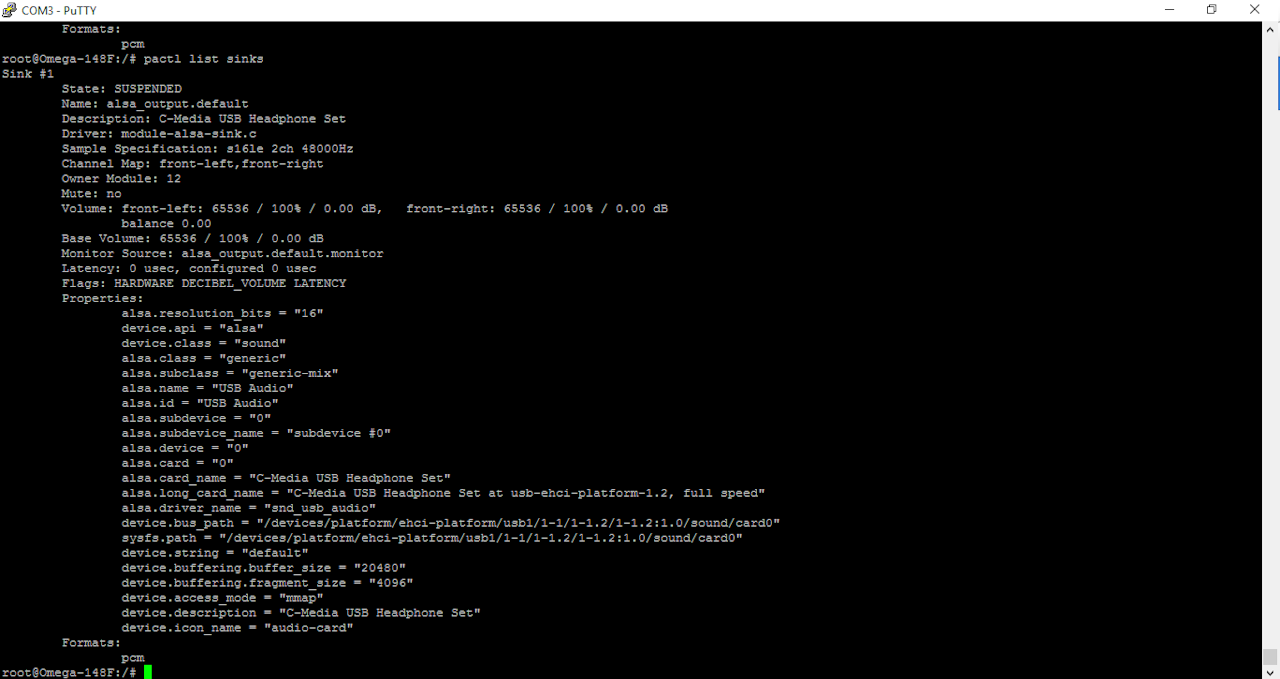

We should do the same for the audio sinks, to confirm that our USB sound card is listed as a sink.
pactl list sinks
You should see a similar screenshot. In our case, the USB sound card is recognized as C-Media USB Headphone Set

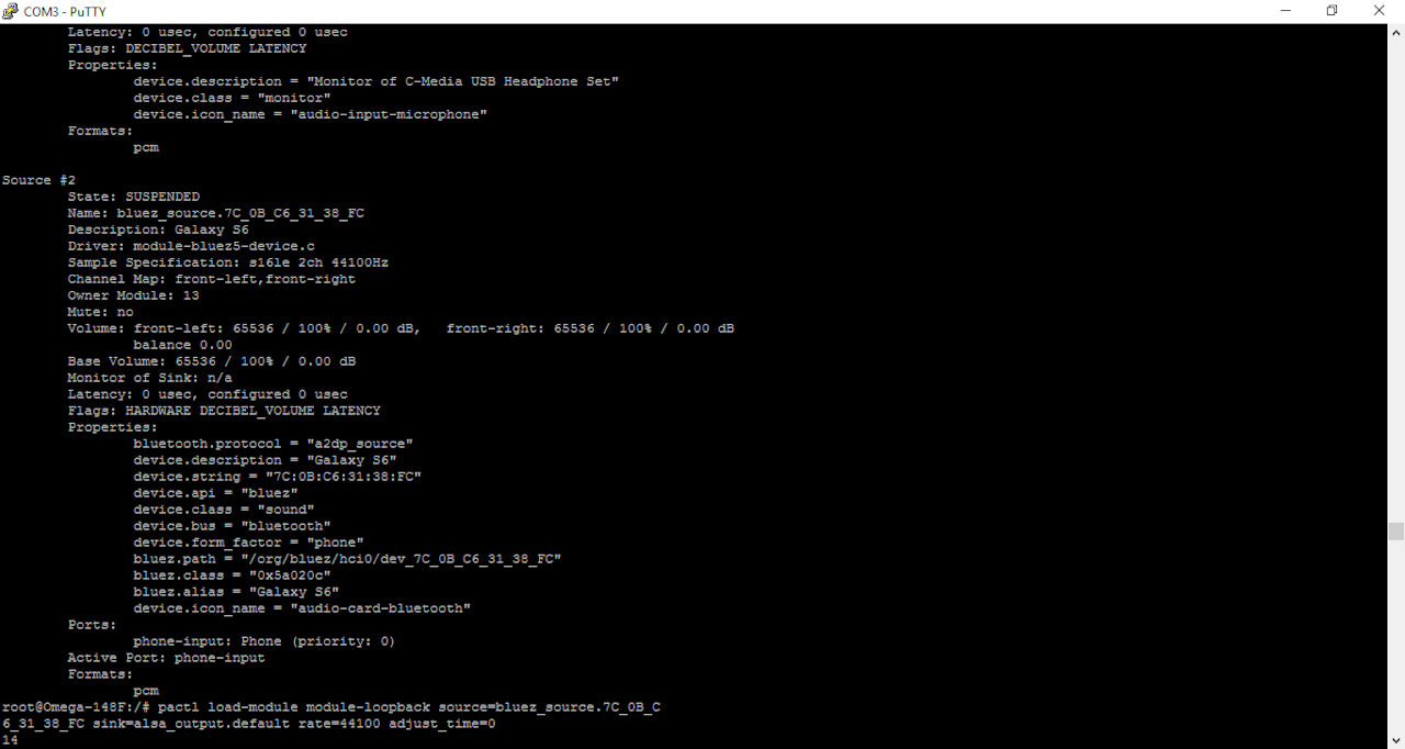

Connect your speakers or headphones (make sure the volume is low). Run the command below, replacing the source/sink names as listed in the previous two commands.
pactl load-module module-loopback source=bluez_source.XX_XX_XX_XX_XX_XX sink=<Sink Name> rate=44100 adjust_time=0
