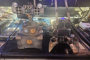

Reach Robotics’ MekaMon is a gaming robot with no environment sensors but cool four-legged motion, normally controlled with a phone app. This project demonstrates how it can be enhanced and made into a fully autonomous robot.
I used a packet sniffer to work out how to issue the right commands over Bluetooth to take control of the Mekamon. I put a Raspberry Pi 3 on it and built a gimballed camera head with a standard Pi camera and an ultrasound rangefinder on it (which I didn’t end up using).
I produced a demo that makes the head follow a coloured ball and walks the robot around to keep the ball in range. This used Python and the OpenCV, Adafruit BluefruitLE, and PiCamera libraries.
I revised the design to use a Pi CM3 for its dual camera inputs, upgraded the head to a custom stereo camera, and made 3D-printed parts to replace the messy aluminium and perspex parts. I have made some progress towards doing visual SLAM + navigation using ROS and RTAB-Map.
This was a university project for my Robotics degree at UWE Bristol, UK. My aim was to see if Mekamon could be adapted cheaply to be used in education. I’ve just finished the degree but I’m interested in continuing this project or seeing other people pick it up as there’s a lot of ideas I didn’t have time to complete or even try.
The project as it is does not damage, or change, anything on the robot; it’s a stack of parts that simply zip-ties on top of it.
I have uploaded example code and the .STL files for the printed parts.

Clearly, it’s not a mature design but an experimental setup that you would adapt to suit. If you just need one camera you might be ok with a Pi Zero, which could allow you to mount the computer on the gimbal head, making it much smaller and avoiding the awkward FFC ribbon cables. (I will try this if I get monocular visual odometry working.) Or you might not need the stabilising gimbal at all, or use different sensors, different computer and so on.
The main thing with this project is it shows the Mekamon can be hacked!

    Reach Robotics haven’t yet released an API or anything to allow custom control of the Mekamon. I couldn’t make sense of the BLE services and characteristics. I took it apart and saw it uses a Nordic nRF51822. (and its brain is a PIC32 (and it has a connector called “Shhh! secret connector!”)). I thought that maybe it uses the standard Nordic UART service, and one shows up on a Android BLE info app.
    I watched the packets coming from the Mekamon phone game app using Wireshark and an Adafruit nRF BLE packet sniffer. It took me about a week to work out how to talk to it. It is using the UART service, not BLE characteristics. When it connects there’s a lot of mysterious stuff that goes by but then it settles down and sends the same command repeatedly until you use the onscreen joysticks in the app, when they change accordingly – these are clearly movement commands; 3 signed bytes for fwd-back, strafe, turn. If I replicated all this exactly I could take control. I worked out by elimination that a lot of the startup stuff is unnecessary except for two.
    The frame structure is a header byte, a command byte, optional payload bytes, a checksum byte and a zero terminator byte. The meaning of the first byte was unknown and there was a weird behaviour where bytes that should be zero get replaced with 1-5, depending on which of the 3 axes were active. I laboriously made a table of what causes what, before someone told me about Constant Overhead Byte Stuffing!
    So for example, when in joystick mode but idle, it sends hex:
    02 06 01 01 01 0C 00
    which is COBS header, command #6 for motion, zero on the 3 axes, checksum, terminator.
