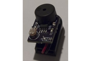

Hackaday.io Hackaday.io
Sign up Log in
BrainDead MPPT Solar charger 35V/8A
Simple solar charger 35V/8A with automatic MPPT supporting SLA/Li-Ion/LiFePO4 up to 8s
adam-luanskAdam Lučanský
Following Follow project
Liked Like project
Become a Hackaday.io member
Sign up with Github
Sign up with Twitter
OR
Forgot your password?
Just one more thing
Pick an awesome username
hackaday.io/
Pick a few interests
Choose more interests.
OK, I'm done! Skip
Join this project
Public Chat
2.5k views
0 comments
28 followers
16 likes
  • Description
  • Details
  • Files 1
    • View all
  • Components 0
  • Logs 1
    • View all
  • Instructions 0
  • Discussion 0
View Gallery
Public Chat
2.5k
0
28
16
Team (1)
  • adam-luanskAdam Lučanský
Join this project's team
  • Design files
hardware
ongoing project
solar Charger LTC4015 liFePo4 Li-ion Lead-Acid NTC pcb automotive kicad
This project was created on 08/16/2018 and last updated 8 years ago.
Description
PCB DIN-rail mountable MPPT solar charger (software-less), as well as ideal-diode prioritizer (if battery is full, load is powered directly from solar panel without cycling battery).Prototype PCB is in production (as of 20.8.2018) and soon ready for testing.More info & schematics: https://github.com/lucansky/BrainDeadMPPT
Files
BrainDeadMPPT.pdf
Schematic of the PCB
Adobe Portable Document Format - 71.23 kB - 08/31/2018 at 18:18
Preview
Project Logs
Collapse
  • Prototype boards arrived
    Adam Lučanský • 08/31/2018 at 11:43 • 0 comments
    2x PCB assembly ready. All components available for soldering.
View project log
Log In/Sign up to comment
Become a Hackaday.io Member
Sign up with Github
Sign up with Twitter
OR
About work - This charger prevents our battery from getting overcharged. When the battery is full, it automatically cuts off the power.
Project Owner Contributor
HOW TO MAKE AUTO BATTERY CUT-OFF CHARGER
jtechjtech
My attempt at a non-destructive LiPo retrofit for the unique-yet-somewhat-loathed HP 28S calculator
Project Owner Contributor
HP 28S LiPo Battery
tomcircuittomcircuit
I'll show you how to design and build a sophisticated solar battery charger from the ground up.
Project Owner Contributor
Build a Solar Battery Charger at Home!
diy-guy-chrisDIY GUY Chris
Making myself a power meter for my road bike
Project Owner Contributor
Bicycle Power Meter DIY
ultrareidarUltraReidar
Going up?
© 2026 Hackaday
Yes, delete it Cancel
You are about to report the project "BrainDead MPPT Solar charger 35V/8A", please tell us the reason.
Send message
Remove Member
