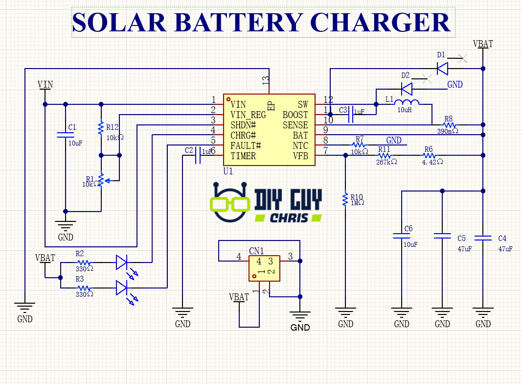

Schematic & PCB Design
We start by creating the circuit blueprint. Using Altium Develop, I translated the LT3652's requirements into a functional schematic. The design centers on two critical voltage dividers: one on the VIN_REG pin to set the MPPT voltage (~14.4V for a 12V panel), and another on the FB pin to set the battery float voltage (~4.2V). The JST battery connector, status LEDs, and all passive components were placed to ensure a clean power flow and easy assembly.

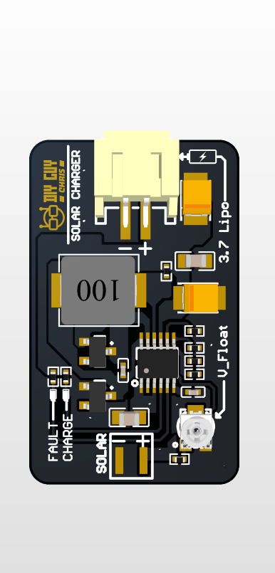

The PCB layout prioritizes a clean power path. The power traces from the solar input, through the LT3652, inductor, and to the battery are kept short and wide to minimize loss. The sensitive feedback networks for VIN_REG and FB are placed close to the IC to avoid noise. The final board measures a compact 35mm x 25mm. Before sending it off, the 3D model view is crucial for a final check, ensuring...
