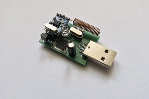

As you can guess from the project title, this new device will offer both the (relative) security of a USB connection and the ease of use of Bluetooth connectivity, together with a complete hardware structure overhaul.
Contrary to all our previous Mooltipass devices, our new platform uses 2 microcontrollers: a MCU considered as secure and a standard one. In practice, they are MCUs from the same ARM Cortex M-0 family. As you can imagine, this involves lots of firmware coding so contributors are highly welcome!

The Mooltipass team currently has a few hardware prototypes, that we made to first make sure that nothing technical was getting in the way of this (very) ambitious project. We have a green light!
