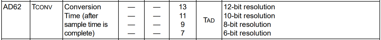

The next step is using the stored voltage on the capacitor to calculate the voltage and that time depends on the bit-depth selected:
We chose to use 6-Bit mode to give us the fastest conversion time (and becouse our screen is only 64 pixels tall or 6 bits tall). However this gives a total conversion time of 3 Tad + 7 Tad = 10 Tad or 200ns, only 5 Mega Samples Per Second. In order to get an even faster sample rate, up to our 20Msps target, we need to use a technique called interleaving.
