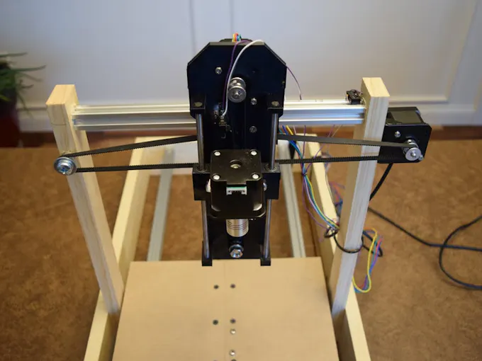

3Improving the Machine
My initial project did have some flaws, however, as brought to my attention in the comments section of it. For one, the X axis belt had uneven tension. This could cause the movements to not be as precise. The X axis carriage also didn't fit onto the rail tightly enough, causing the entire assembly to tip over and grind against the rail. To fix this I completely redesigned the X axis carriage block by moving where the timing belt fits in and moving the V slot wheels to better locations, as well as adding another wheel to the back to prevent tilting.

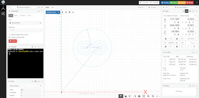

5Controlling the Machine
DFRobot helped sponsor this project by sending me the new Raspberry Pi 3 B+ and a 5in TFT Touchscreen. To start I downloaded the latest Raspbian image from https://www.raspberrypi.org/downloads/raspbian/ and then using Etcher.io to put it on an SD card.

and finally install the control software with
sudo npm install --unsafe-perm -g cncjs
and
cncjsto run it. Just go to http://<RPiHostname>:8000 to access the page. Also make sure to connect a USB cable from the Arduino Uno that's controlling the CNC machine to the Raspberry Pi running the CNCJS server.![]()

Now that everything's prepared, it's time to decorate a cake. First I homed all the axes, making them touch the limit switches. Then I touched "down" on the touchscreen to start the icing extrusion. Then I clicked start on the cncjs webpage to make the cnc machine follow the gcode.
