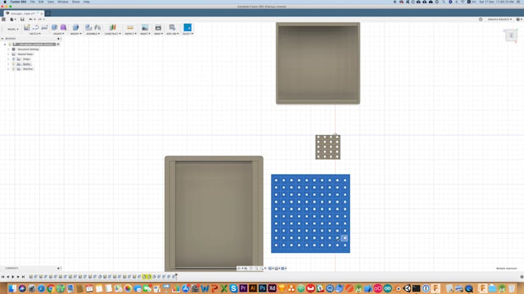

Step 2: Design the Grid Container With AutoDesk Fusion 360
Base on the size of the seed, I use fusion 360 to design a grid pattern system which can hold the seed and let it germinate. Since my 3D printer is not that accurate, after several trial and error, I finally figure out a grid holder that can place my seed.
In each of the grid, you can see that there is a little hole at the bottom. The purpose of the hole is to let the water drain out and create a space for the root system.
Step 3: Design the Water Container Underneath
I also design another container to hold the water underneath. This design will guide the development of the root system to the boom. This is very similar to a hydronic kit. After several trails. Here’s the design that I finally come up.

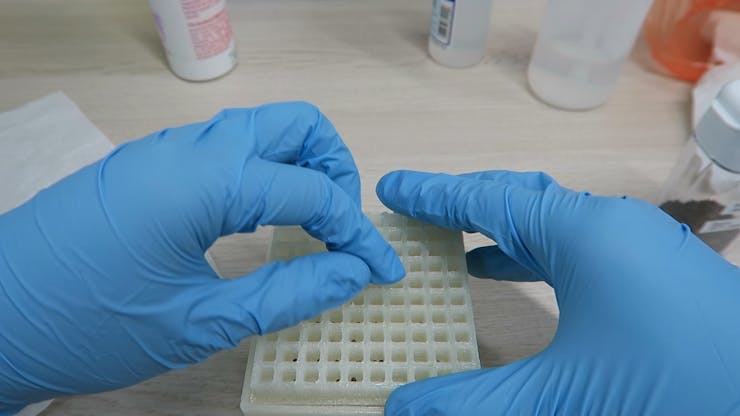

Step 4: Broccoli Seeds Start to Germinate
I start to plant some broccoli microgreens. I put 1–3 seeds in each of the grid in order to see the differences later on. After several days, the seeds start to germinate and the root system developed to the bottom as I expected. If you want to know the growing progress of these microgreens, please feel free to check out my Instagram later on.
