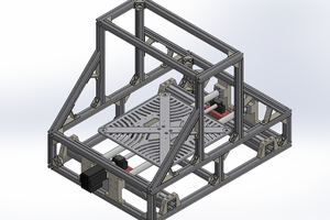

Simple Workout Timer
My daughter has a great idea for a simple wearable timer for her workouts. We'll build it together!
108 views
0 followers
  • Description
  • Details
  • Files 0
  • Components 0
  • Logs 0
  • Instructions 0
  • Discussion 0
My daughter wants a simple timer that can be worn like a Fitbit while she's in the gym. She wants to tap the face to set a 30, 60, or 90 minute timer, and have it vibrate and beep when the time is up. I'm thinking something like a Nano in a 3D-printed case with a piezo element for both sensing the taps and sounding the beeps. Still in the conceptual stages now, hope to start breadboarding over the Christmas break.
