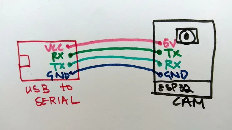

1. As there is no micro USB port on the ESP32-CAM module hence we add an external USB port using a breakout module for powering the project easily.
2. So I connected the +5V and GND lines of both the modules as shown in the hand-drawn diagram.
3. That's it for the connections! Test by powering up the module and you'll see the white led flash for less than a second.

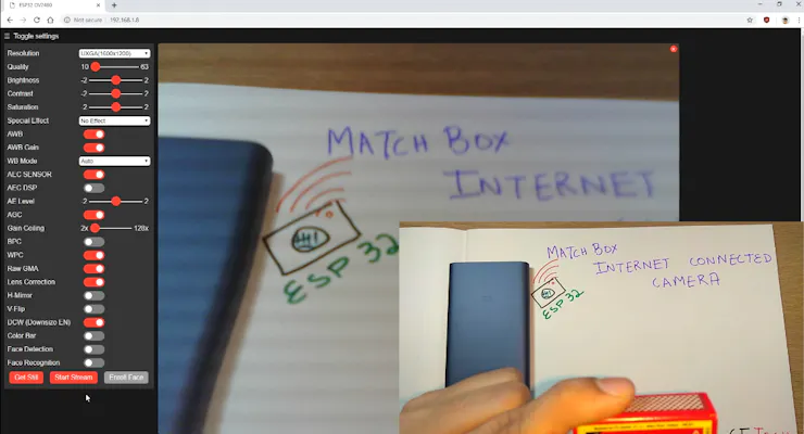

6Playing With the Camera
Open a web browser in any phone or computer and head over to the IP as shown by the serial monitor.
If the serial monitor is not accessible for some reason you can use Angry IP scanner to see the IP of the camera.
As soon as you enter the IP on your browser you will be able to see a webpage which has different options to configure the camera which you can use.
Enjoy securing your candies with this camera!

Download the GitHub repository: https://github.com/akarsh98/arduino-esp32/tree/mas...
You need to connect the ESP32-CAM module with a USB to Serial as per the diagram is given and then connect the setup to your computer.
1. Open the sketch from GitHub in the Arduino IDE.
2. Navigate to Tools > Board. Select the appropriate board that you are using. ESP32 dev Module.
3. In partition select No OTA (large APP)
4. Select the correct comm. port by going to Tools > Port.
5. Connect the GPIO0 to GND and hit the reset button on the module.
6. Hit the upload button.
7. Disconnect the GPIO0 with the GND and hit the reset button.
8. When the tab says Done Uploading you can open the serial monitor to see the IP at which the camera will stream.
