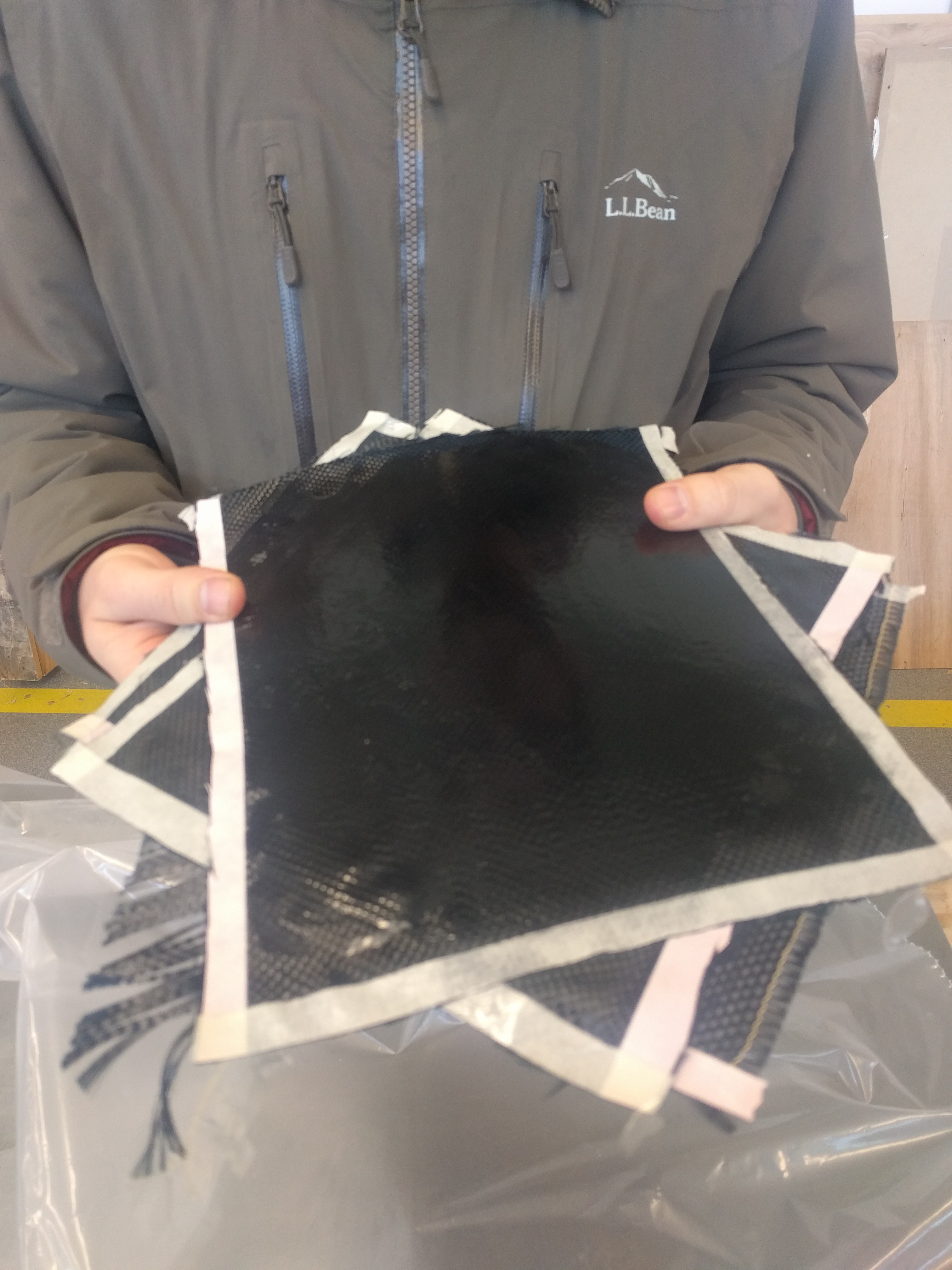

Sample Composites
04/01/2019 at 14:47 • 0 commentsTo get a feel of lay-up a couple samples were devised.
All samples came out pretty well considering we didn't put them under vacuum.
