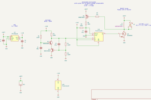

A much simpler and cheaper approach is to have the ATtiny regulate its own power supply by monitoring Vcc (battery supply voltage) and controlling the converter by its solar cell input (SOL), using 1 GPIO pin. This is a simplified switched-mode power supply.
A garden light turns off its LED when the solar cell is charging the battery during daylight. At night the solar cell doesn’t charge and the converter, sensing this, turns on the LED. For this hack a GPIO from the ATtiny connected to the SOL input mimics the solar cell activity, making this a converter on/off switch.
Typical garden light circuit using YX805A converter chip (this chip isn't recommended.)
Internal to the ATtiny is a way to measure Vcc using its ADC and an internal 1.1V bandgap reference, Vbg (see Microchip AN2447 for details.)
By free-running the ADC to periodically sample Vcc, the SOL output is toggled based on a selected threshold voltage. A filtering cap smoothes this bang-bang control.
In normal operation Vcc is kept close to the target voltage regardless of power draw (within the converter’s limits.) An added bonus is the threshold voltage may be lowered for a low-power mode, thus extending battery life.

Demo Circuit Using YX8051 Converter Chip:
This circuit shows the mods required to use a garden light. C1 can vary but not recommended below 10uF to keep voltage swings down.
