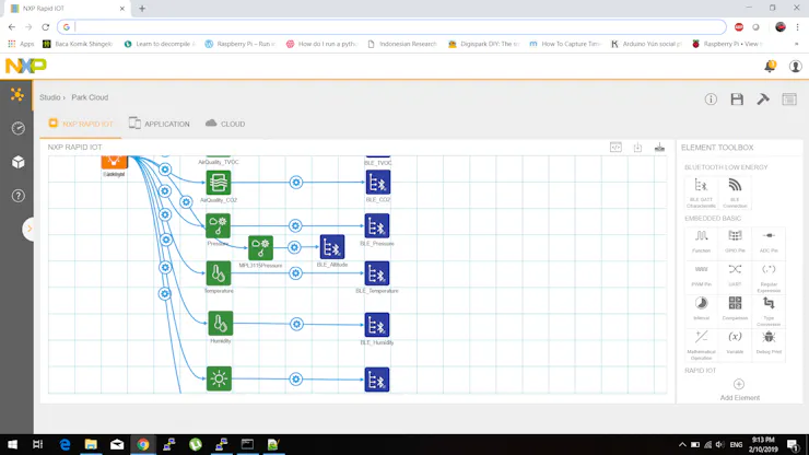

  • 3
    Program the Rapid IoT Kit
    The code and firmware that used for this projects are attached below. To reserve power I turn off the backlight and only send the data I need for the project. If you want clone the project just import the.atmo files attached below
